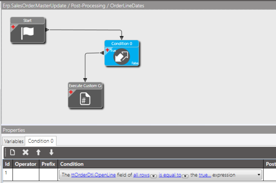

I have a Data directive BPM that updates the ship by date backwards a number of days depending on the ship to location, this is working fine on the update or creation of order lines. However I’m trying to figure out how to make this retroactive across all of our current open lines in our database, only need to do this once.
I’ve tried setting it up as a Method on the UpdateMaster directive in SalesOrder, but that didn’t seem to work when i tried updating an order line to trigger the directive. Is there anything i’m missing here?
Trying to do it 1 time? Don’t trigger off that BPM. You’ll want to trigger it off of some very custom table, i.e. use an Update condition on a UD table where something equals true, as an example. Then you invoke your code from that.

Can just simply make a BAQ that does the calculations in a calculated field? Then you should just be able to take those results and DMT the changes in, no BPM needed.
If you can’t do it in and BAQ/SQl you can always to an advanced BPM only BAQ that loops through your results set and use the same code update a blank the field in your BAQ. Then like before, send the results to excel, and DMT in the changes.

BPM’s only work with the data set that is loaded on that specific transaction. And the BPM is only triggered when there is a change. (for an update BPM anyways) So to get that to work, you would have to figure out how to load all of those transaction, and fake out the system to think that there is a change so it actually processes. That’s not easy to do.
Now, if you make a BAQ that get’s the info you want, you can make a BPM that acts on the BAQ information, and you can probably copy most of the code that you have in that into that BAQs BPM and utillize the code. That’s not too hard. You would just loop through the results.
