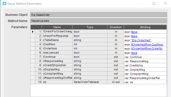

Hoping for some help with triggering the masteupdate on sales order from the update on sales order,
I have currently created a dashboard for out despatch department, from this they can change a UD field to trigger an allocation BPM stored on the MasterUpdate.
Unfortunately the updating from the dashboard does not trigger the master update only the update, so i have a BPM that is locked down to just that dashboard to trigger the masterupdate to trigger the correct bpm etc.
However using a tool to test the logic of triggering the BPM i have been unable to trigger the masterupdate.
Could someone please narrow down the correct parameters for me to trigger this please,
The parameter I’m convinced i have incorrect is the cTableName
