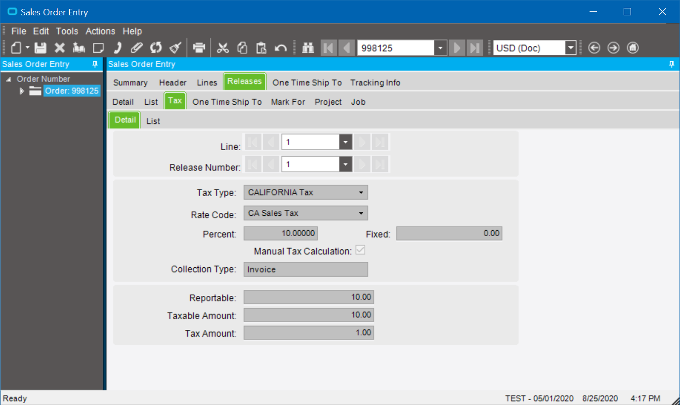

When you set OrderHed.TaxRegionCode, Epicor creates an OrderRelTax for each OrderRel using the tax rate associated with the tax region. If you go into the OrderRelTax row in the Order Entry UI, under Releases/Tax/Detail, there’s a “Manual Tax Calculation” checkbox. When checked, you can override the tax rate from the tax region:
The new rate is correctly reflected in the tax amount and order total on the order summary page. But when we invoice the order, it seems to only consider the default tax rate for the tax region. The tax amount on the invoice is incorrect. Alternatively, if we don’t set OrderHed.TaxRegionCode and create the OrderRelTax manually, again it’s reflected correctly on the order, but the invoice doesn’t include any tax at all.
Is there a trick to making this work? We’re on 10.2.100.

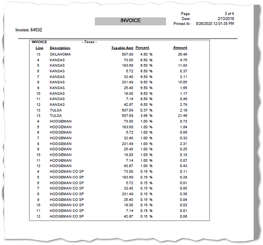

Here’s the tax section from a single invoice with just 13 lines:
Avalara might be great if we were entering orders directly in Epicor. But again, we want to record the tax actually collected on the websites, not what Epicor thinks is correct. I wonder how Avalara controls the tax that appears on invoices. Does it create a huge number of codes and rates on the fly?
Yes.creates codes as needed. You do have to create some of the elements yourself (like Tax Categories).
