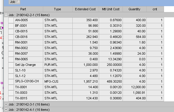

I have a requirement to collect Job Actual Cost data “up to X date” and I’m struggling on how to properly get the material costs. (I’ve got labor worked out fine). As a Note; I won’t be able to use existing project analysis or anything like that because I need to break down the costs by some additional criteria.
I’ve narrowed it down that I need to collect parttrans records up to my “X date”, but the problem is that there are loads of transaction types, and I don’t know which ones to filter by in order to get the right numbers. I should note that I am also FAR from an accountant, so much of the terminology is very fresh to me.
Does anyone have any insight as to which transaction types I’d need to include/exclude? So far, I’ve had my best luck on a sample project by excluding transactions with the class of “A” and “S” and this got me correct results for that sample, but the project only had maybe 3-5 different actual transaction types present, and didn’t have any “D” or “X” class transactions.

Thanks for the speedy replies! I’ve looked into your suggestions and it looks like MFG-CUS actually throws my numbers off (Added or subtracted) are you sure those contribute to the actual cost? I’m essentially trying to match against what would show on the “actual” column of project costing analysis if that helps.
Ross’s note about
That makes sense except for maybe the “out” ones… that MFG-CUS one actually gives me the wrong number when included. would there be issues with the other “out” transactions do you think?
Are you only trying to get the total cost accumulation at a date or the net balance (cost in/out)? The * -X transaction examples are going to capture the costs going in to the job and the X- * transaction examples are going to capture the cost going off the job (job receipts to inventory, shipments from the job, inspection entries, etc.). The MFG-CUS is a customer shipment directly from the job. That will carry material, labor, burden, subcontract values and take if off the job.

A good way to see what you are dealing with is to just do a complete dump of the parttran records for a specific job number in question. You can see all of the transaction types, the unit cost breakouts and the extcost field. That should tie back to your cost add/removal from the job. If you want to post an excel file on this thread I can take a look and add comments.

Sorry, I’m still having a slightly hard time finding the right terms in this area of the system. We are trying to get a collection of accumulated costs (the total job costs up to a point). Same thing that would show up on job analysis at the end of the project for actual costs.
And we will have some purchases going for inspection and DMR, so those may factor in.
What I’ve been using to check my work on my few samples is the “build project analysis” function in project entry. It gives the accurate totals we want to match against for actual material costs, my QRY is just breaking down those costs according to some additional criteria.

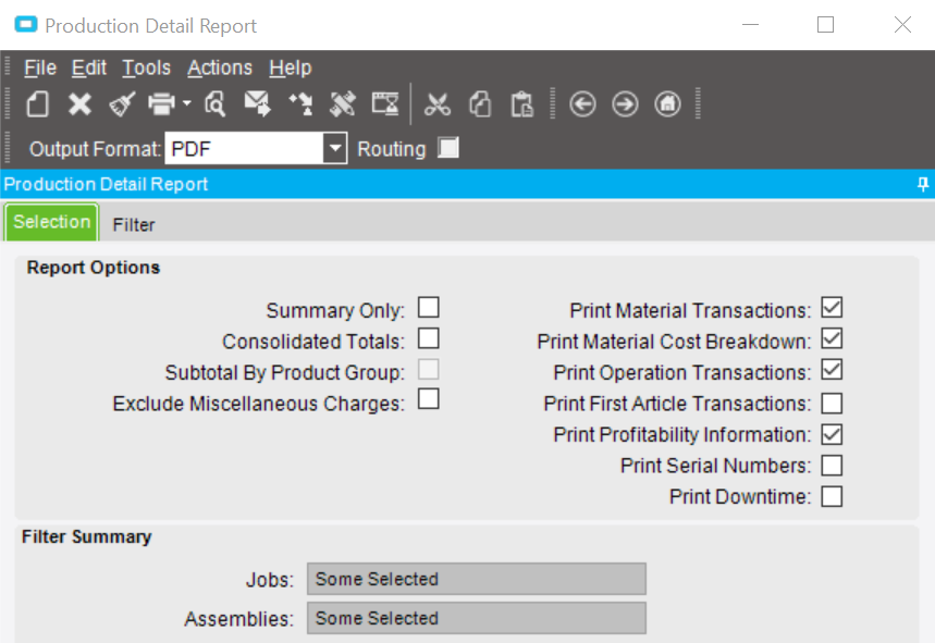

There is a built-in report that you can use called “Production Detail Report” available as a stand-alone report or from Job Entry/Tracker. It gives you the summary of all costs with the ability to print detailed transactions.
