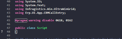

But if you really need to use Enabled or ReadOnly, which I also use when I have a valid case, you can disable the warning. Let’s face it… ReadOnly and Enabled aren’t really going anywhere, they will remain part of WinForms.
Add this underneath of your using statements.
// one is for Enabled, one is for using return; in a void method
#pragma warning disable 0618, 0162

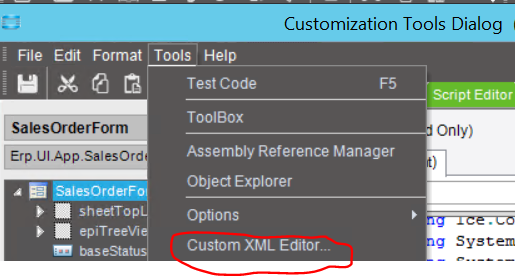

Remove it from the xml in the actions menu
Find the xml line that refers to enabled and just delete it

This warning/error can be shut off/ignored by putting just after your ‘using’ and before ‘public class Script’. Thanks to hasokeric for that tip.

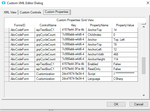

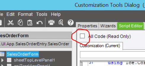

I found that the All Code checkbox allowed me to see the read only code so I could identify which two were the culprits based on the line numbers of the warnings.
josecgomez guided to the Custom XML Editor.

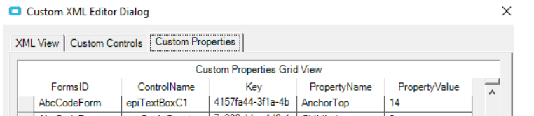

I couldn’t find the Enabled property in the XML View, but could use Hally’s ‘Custom Properties’ tab to find the Enabled properties for the 2 textboxes, select them, and press delete.
