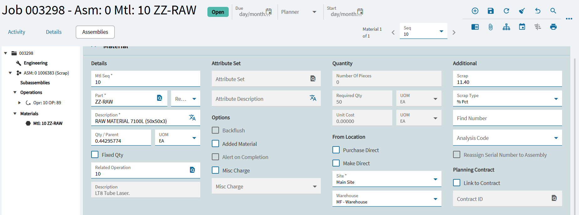

Sorry to bring this old thread back to life, but we’re facing a similar situation during our implementation. I tried this method, and it works more or less as expected.
However, when batching jobs, we might end up over-issuing material since this method doesn’t account for the possibility of using the remaining length to cut another part in the batch. I realize that automating this would be quite complex, so I understand if that’s beyond the scope.
My question is: why adjust the quantity per each instead of accounting for this difference as scrap?
For example:
Part usage = 0.442957746 (EA) per parent
  • Since we can fit two of these per raw material length, based on your explanation, the usage would be set to 0.5 (EA) per parent.
  • Why not leave the usage at 0.442957746 (EA) and add 11.4% scrap instead? (Since 0.443 × 2 = 0.886)
Wouldn’t this achieve the same result while keeping the original quantity values intact?

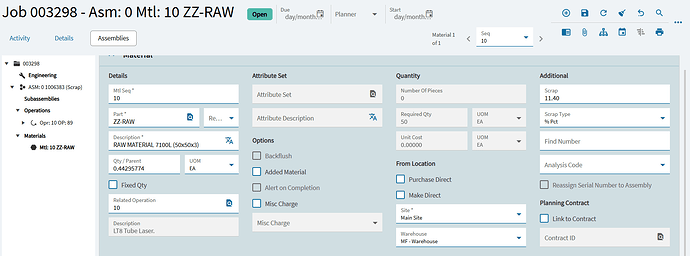

The attached image represents a job for 100 of this component.
Again, sorry to revisit this old thread—I just want to make sure we get this right! :sweat_smile:
Yes, that would acheive the same results… Just remember that you cannot (or should not) be able to return partial eaches back to stock.
