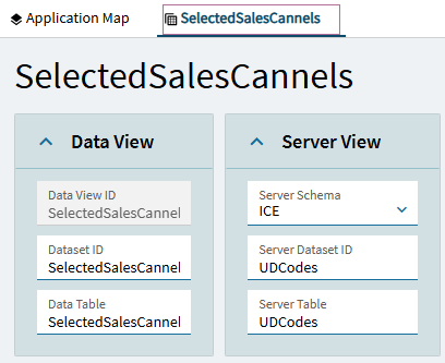

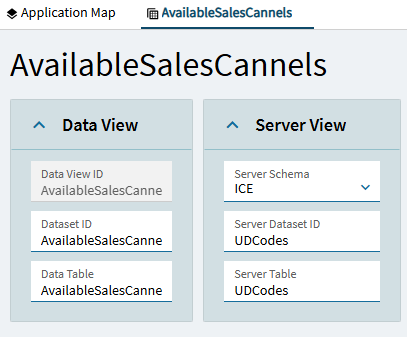

Hello!
In my case using UDCodes instead of UD01, I just change the data view to fit with server table:
and

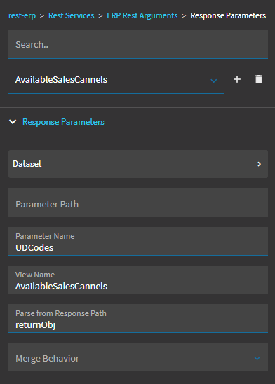

and the parameter name in response parameters:

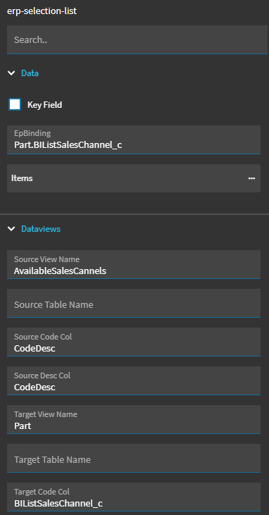

my selection list setup for UDCodes (I think there is no necessary the Selected Data View because the target is a UDColum in Part View)
and follow Hannah’s guide as is!
