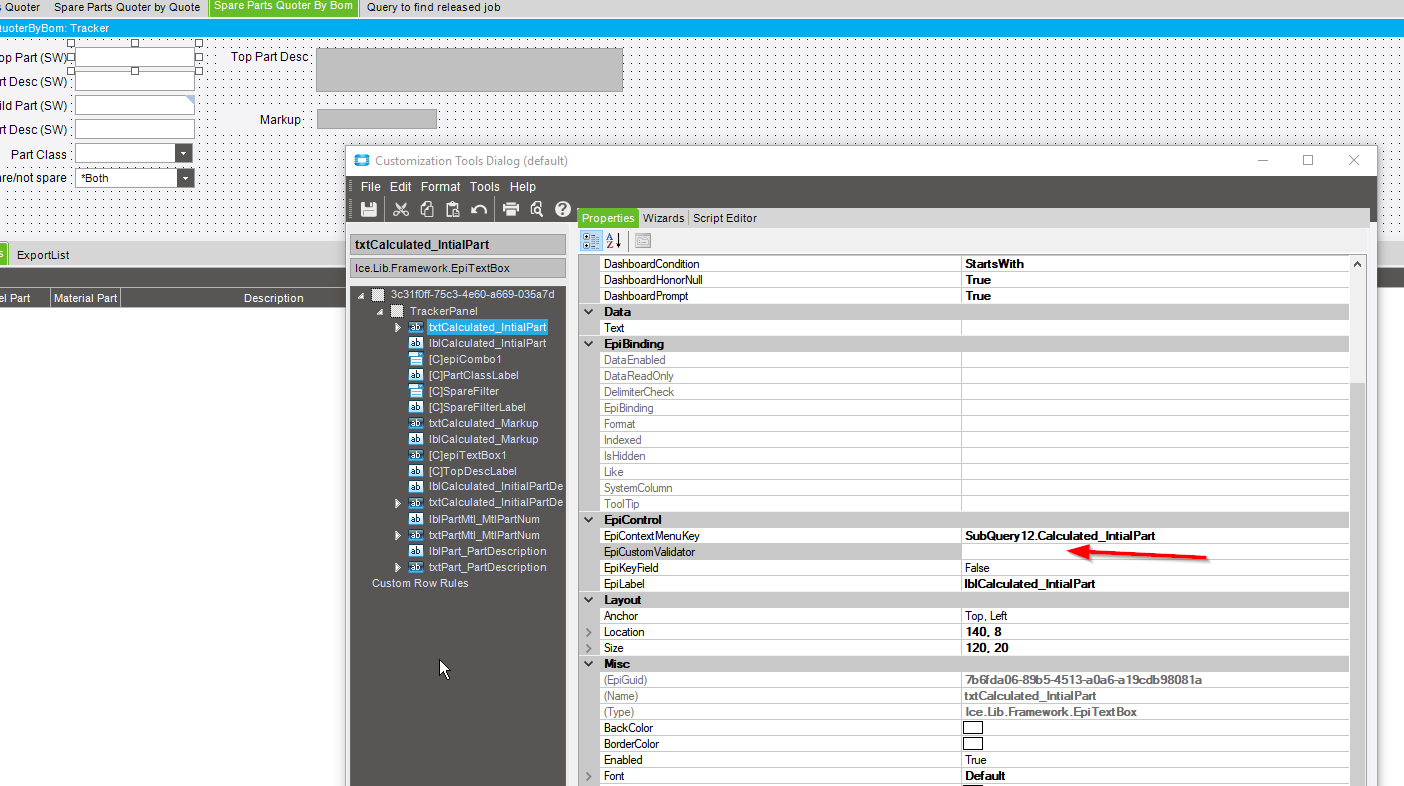

I imagine that I have to put something in the custom validator, but I don’t know where to find what codes are required to make this work.

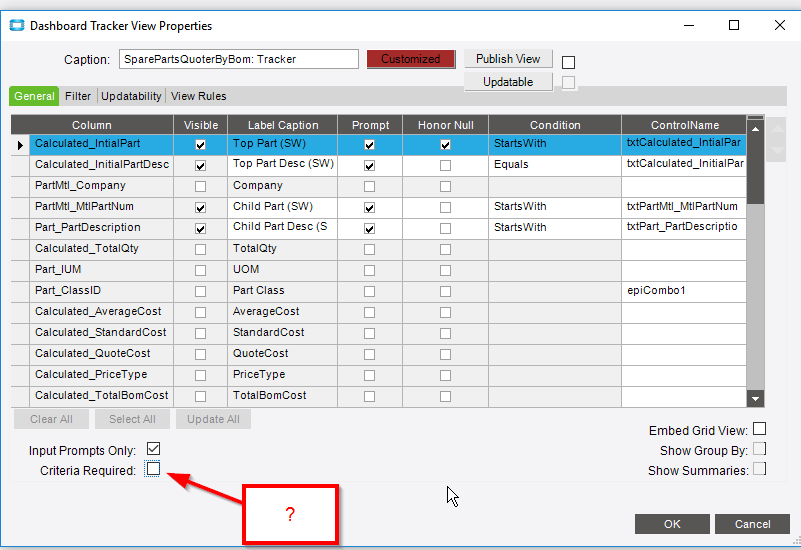

And have you tried selecting “Required” in your Tracker Properties and deploying the dashboard?

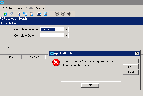

e.g.

Are you talking about this one? Unfortunately that makes all of the fields required, and I only want one of them to be required.
This one
Yes
I wonder if I can do something like this in the dashboard in order to get the parameters directly in the tracker. I’m not sure that this is in quite the same context though.
