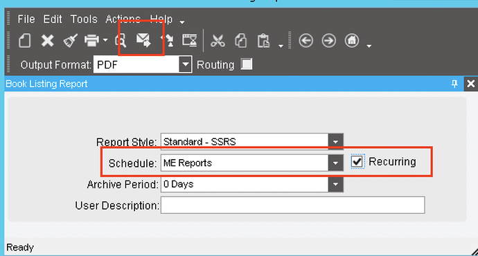

You can setup a schedule in the system agent to run on a specified day (first of month for example).
When you run the report, change the schedule from Now to The schedule you created in the system agent and check recurring.
Make your date selections dynamic. Don’t set the the report to run as of 7/1. Use a dynamic option like First of this month (you can see the options in the drop down).

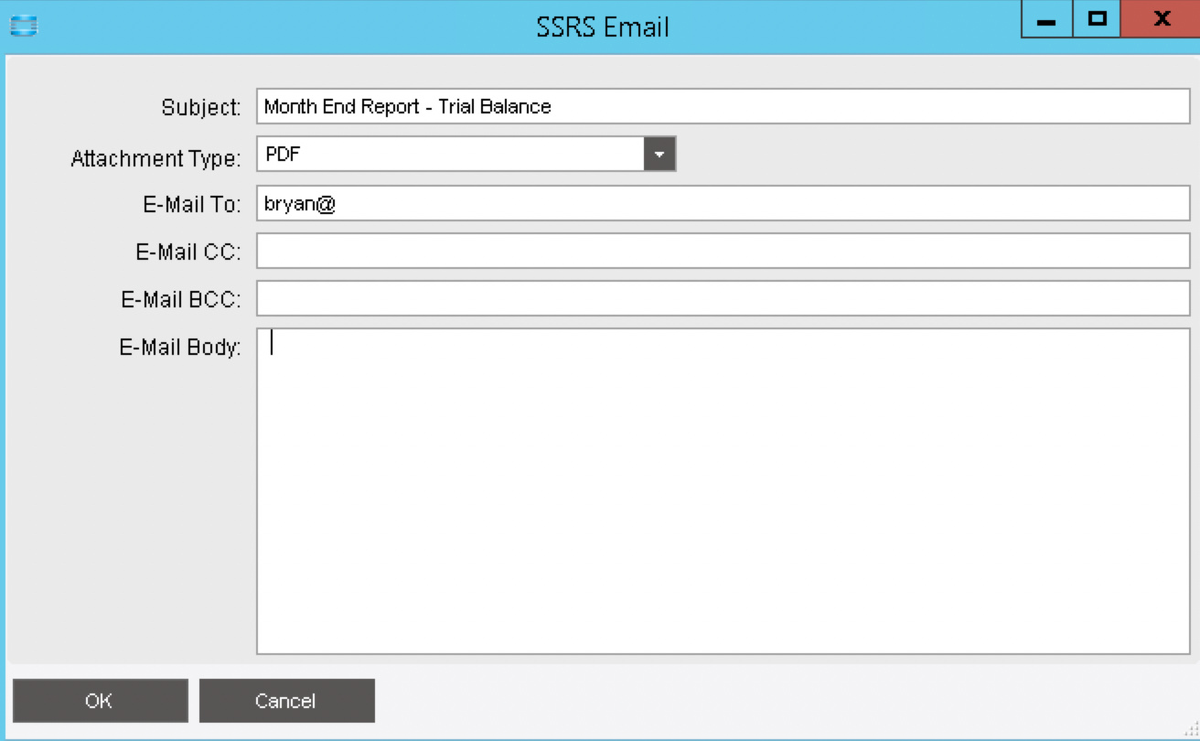

Instead of print or print preview, use the SSRS email option.
When you click OK, the report will be submitted to email with the parameters you specified on the schedule you created.
W can help you further if you choose the email option.

A couple of hints when using the scheduled email method:
  • Make sure that specified date fields are dynamic
  • Add a note in the “User description” this makes it easier to identify which Scheduled task is what.
  • Very important!! Hitting the <enter> key while in any field in the SSRS Email window is like clicking the OKAY button. If you want multiple lines in the email body, use <CTRL>+<enter>
