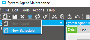

How do I get more entries in my Schedule drop down? I’m sure there must be a place to configure those.
You have to create a new schedule in your system agent @dr_dan
Brilliant! Thank you!
