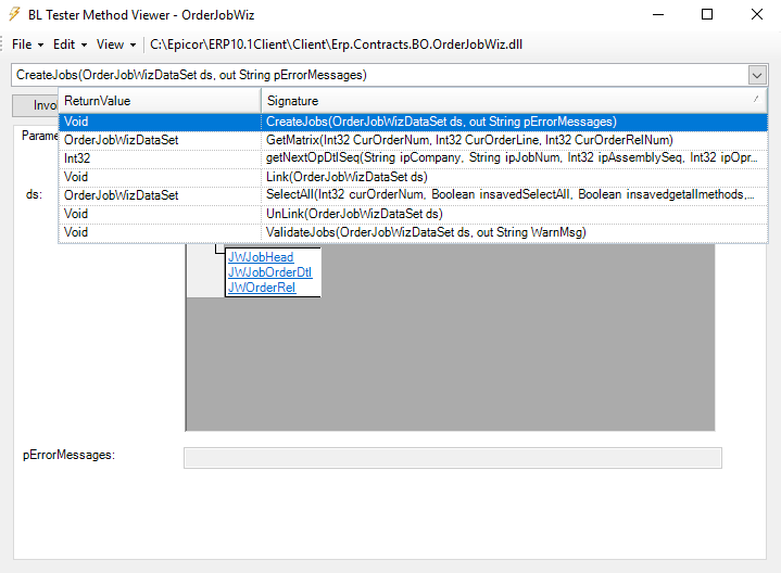

Have you looked at the OrderJobWizard adapter? As Dhewi stated.
The trace shows that ValidateJobs is called before CreateJobs. I still need to know how to fill the dataset that is being passed to ValidateJobs and then CreateJobs.
The trace doesn’t seem to have everything. Was hoping for something like this to work:
        string errMsg = string.Empty;
        string warningMsg = string.Empty;
        OrderJobWizImpl bo = WCFServiceSupport.CreateImpl<OrderJobWizImpl>(_userSession, OrderJobWizImpl.UriPath);
        OrderJobWizDataSet ds = bo.GetMatrix(10165, 0, 0);
        bo.ValidateJobs(ds, out warningMsg);
        bo.CreateJobs(ds, out errMsg);
But it does not create jobs even if you mention the line and release numbers. Also you must enter ship by date on the release prior to attempting to create jobs using the wizard according to the documentation and still no luck.
