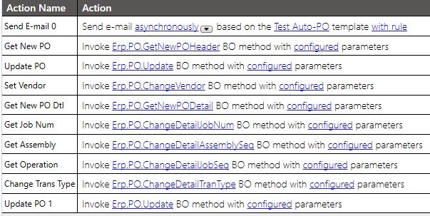

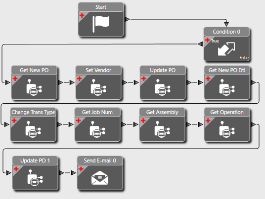

So, I decided to tackle this head on, with my limited knowledge, and surprised myself. It wasn’t as hard as I thought it was going to be, just took a little effort to learn the elements and how to use them.

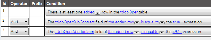

I ran another trace, created my PO manually and replicated it through BPM. I’m able to create an automated PO, no matter how the job is created, by using a standard Data Directive on JobOper like @Jason_Woods had mentioned.
This is what I have so far:
Condition:
Created a POTableset variable on GetNewPOHeader.
The rest is pretty self explanatory
I send myself an email containing the field data, just for verfication purposes. Everything looks in order so far.
