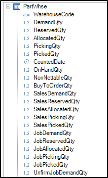

The PartWhse table will have your demand.
There it is. Thank you! I knew this would be an easy one for someone who knew.
You can also get it from PartQty

PartWhse.DemandQty > 0
then I only get 687 results.
Should there really be that much discrepancy? If so, why? Am I just missing some filter criteria?

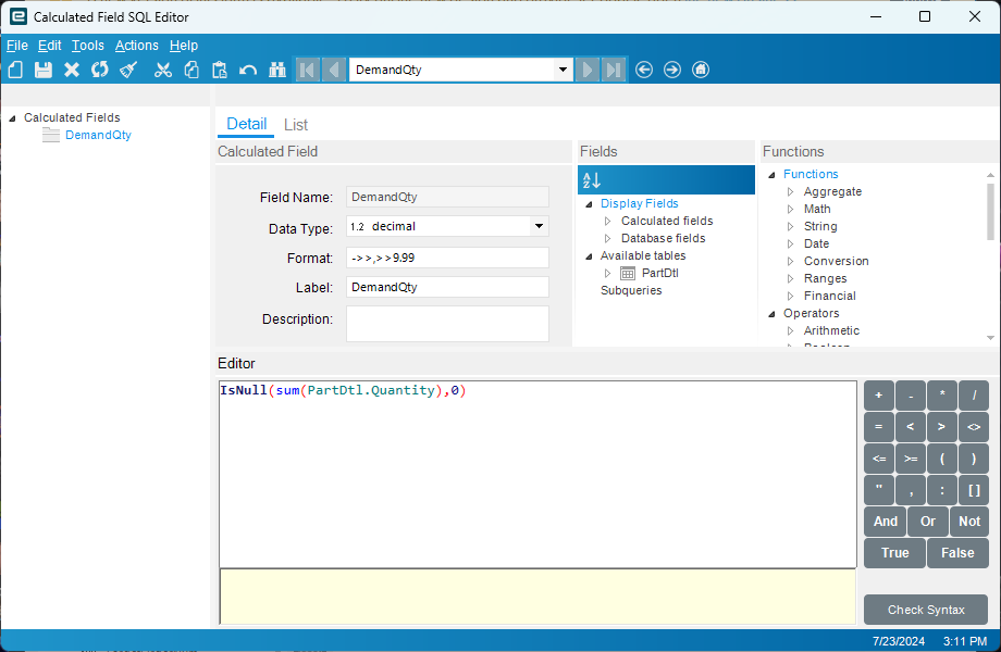

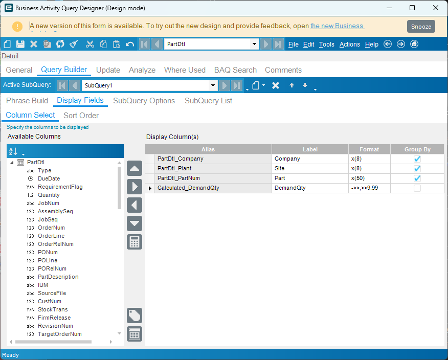

Yes, PartWhse is a summary, but getting back to your need you just need to know if is has any demand, so I would make a subquery grouped by Company and PartNum for a partdtl with a RequirementFlag = true and do an inner join to that so it filters the main query.
Well, maybe, but you can’t necessarily compare row counts. As mentioned earlier, PartWhse isn’t always correct. You can run the utility to synch it up if you want to see if they match then (Refresh Part Quantities and Allocations).
On the other hand, PartDtl is Time Phased (row per date/part combination), so you’ll want to summarize the results most likely. You’ll need to do a bit of Group By to get the totals you want.
You shouldn’t need the PartDtl.Qty > 0 because if there is demand, it’s already more than 0 but I also don’t think it’s hurting anything.
Edit: Group By Company, Plant, Part for example
