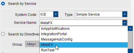

I must be blind, but I can’t find the Ice.Lib.MetaFX in the Method Directive search.
Can you guide me? I really like how you handled this using a BPM.
It should be available in System Code: ICE, Type: Simple Service, Service Name: MetaFX

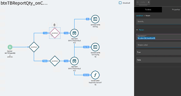

Mike, when you did this with Start Production in MES, did you handle disabling your new button if the user was not logged in yet ?
(I am doing the same thing, and can’t seem to get the disable/enable correctly setup)

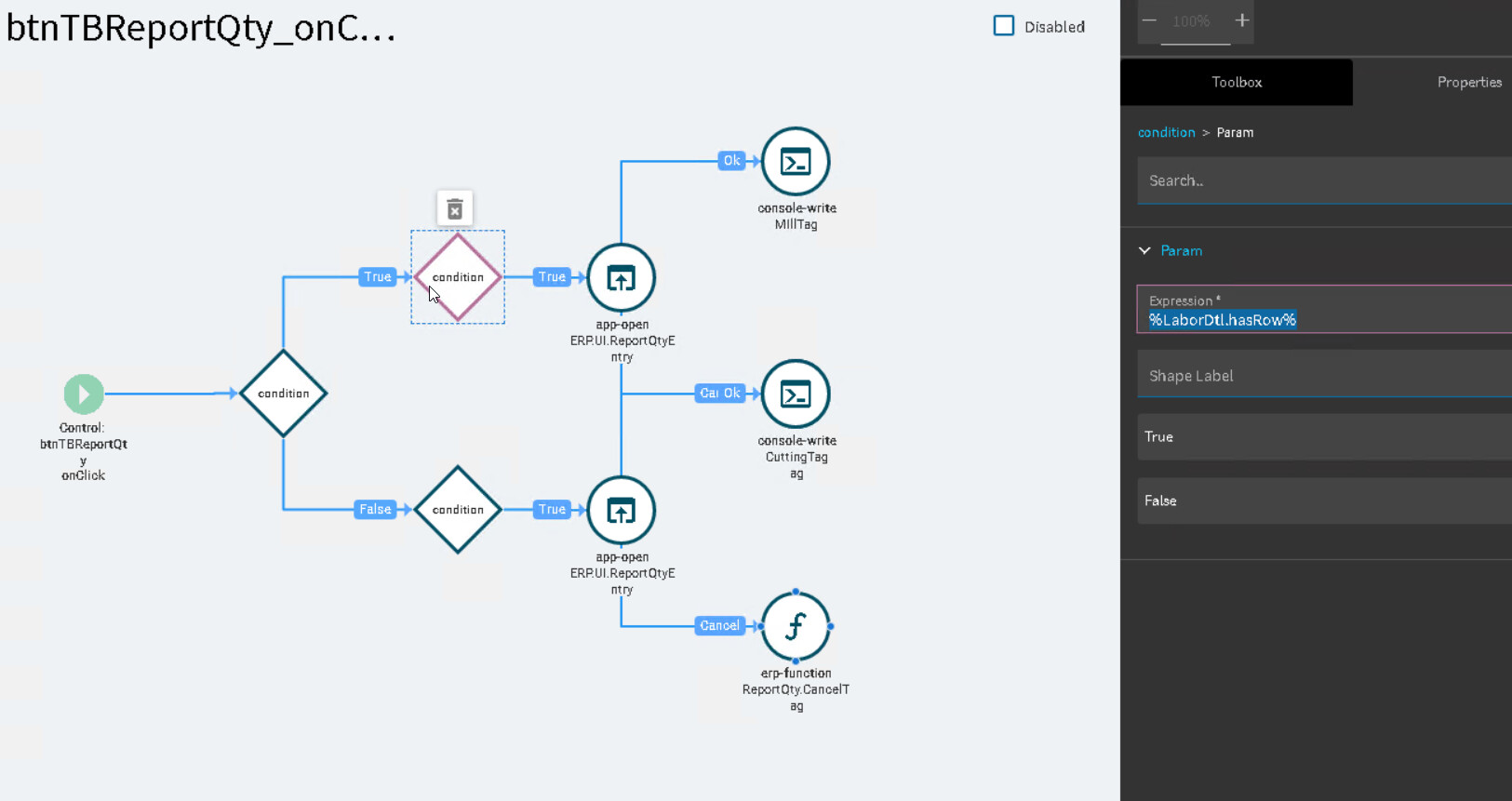

You can try a condition on the button click with the parameter
%LaborHed.hasRow%
Here is an example from my Report Quantity button for the detail
