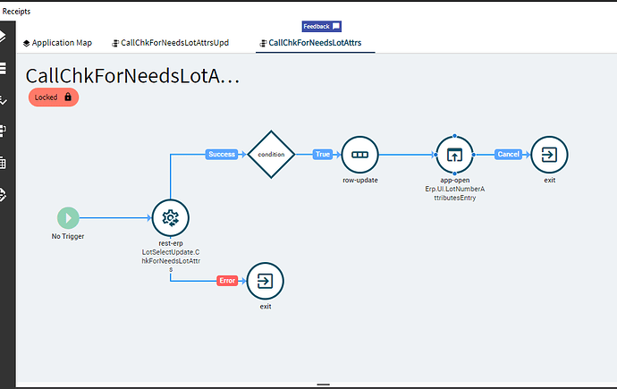

Its a little confusing because CallChkForNeedsLotAttrsUpt uses a rest-erp to call
It doesn’t seem to want to let me hook to this one or override it
The app-open is the one I think I need to update.
but this one I think is the parent to all of it

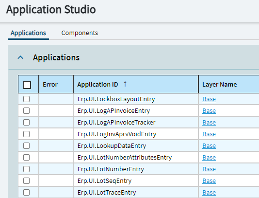

Then why not create a layer on that app and specify the layer to use? It is in app studio.
You DO have to do that step.
But the base event in Receipt Entry (which you can’t edit) calls the base layer of the LotNumberAttributeEntry application.
So, you need to create a copy of the base event in Receipt Entry so you can apply your customized layer to the app-open call.

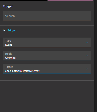

Is this the right way of calling it?
I’ve throw in a dialog box and I’ve restarted my application studio, but the override doesn’t seem to want to trigger.
Should be. Looks correct. :thinking:

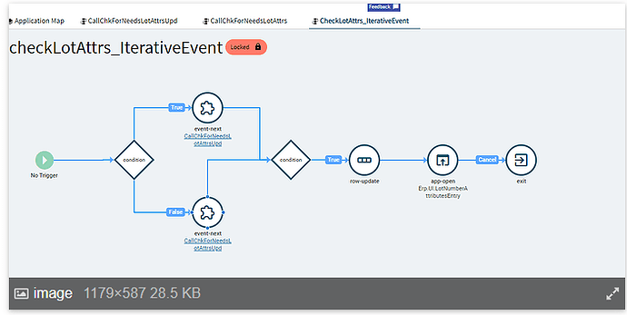

It is odd that the base events seem to call the app-open within two different events.
I don’t know if you’d need two different override events to make sure you capture both cases?? Tough to follow from a distance, and we don’t use lot attributes so I can’t really test this exact scenario out.
