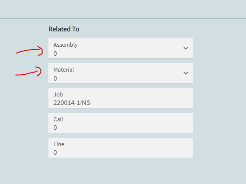

In C sharp, we had Row Rules where you could simply set the Style to ‘default’. It would then allow the field to be editable
In Kinetic, the only options are: SettingStyle:Disable, SettingStyle:ReadOnly and another option to DisableRow Except these Columns. That last option doesn’t work for what I’m trying to do
Is there any way to either execute custom code to enable the field or do it in a row rule or whatever? I’m only trying to enable the AssemblySeq and MtlSeq in the Misc Shipment Entry because for some reason, even if you enter a job, they are ReadOnly. It worked great to enable it before

I found that I can switch the ‘ServiceJob’ field to true but unfortunately, it only enable the MtlSeq field. Not sure what’s going on with AssemblySeq :frowning:

I guess something went wrong with the converted customization from Classic to Kinetic because I started from Scratch and simply setting the ServiceJob flag to true enables both the AssemblySeq and MtlSeq which is perfect for me

I see these two:
      "id": "ruleServiceJob",
      "dataView": "MscShpDt",
      "condition": "ServiceJob = false",
      "actions": [
          "action": "DisableColumns",
          "columns": [
            "MtlSeq",
            "AssemblySeq"
      "customizable": false,
      "disabled": false
      "id": "closedLineRule",
      "condition": "ShipStatus = 'CLOSED'",
      "actions": [
          "columns": [
            "PartNum",
            "LineDesc",
            "XPartNum",
            "XRevisionNum",
            "Quantity",
            "IUM",
            "AssemblySeq",
            "MtlSeq",
            "JobNum",
            "CallNum",
            "CallLine",
            "DMRNum",
            "CustNumCustID",
            "BtnPartDesc",
            "DispNumberOfPieces"
      "disabled": false
