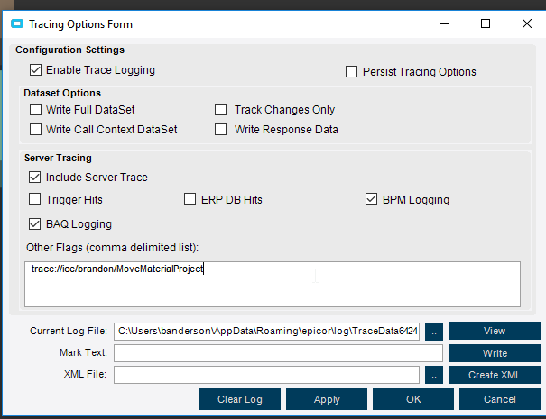

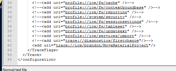

Sorry to bring up and old thread, but can this tracing be returned to the client side trace? I’m looking through help, and you can add server tracing to the client side by added some things in the sysconfig. It looks like I can add the"stock" ones with a trace: and a profile: . I’m trying to figure out if I can get these custom traces to come through like those ones. I’ve tried adding my custom flag "trace://ice/brandon/MoveMaterialProject" to the sysconfig, as well as putting it into the “other flags” portion of the client trace. No luck on any of that.
Did you add this new trace to the server AppServer.config?
Yes I did. I don’t have a profile though. Is that needed?
So new traces are added to server log, but they are not sent to client?
That’s correct.
It looks like a bug, you should report it.
