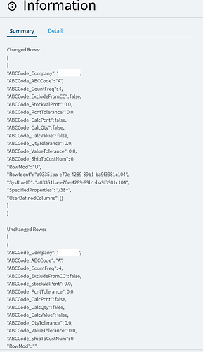

The code for that was basically a condition block to only fire if the actionID was “Test” & this code. →
var changedRows = queryResultDataset.Results.Where(x => !String.IsNullOrEmpty(x.RowMod));
var unchangedRows = queryResultDataset.Results.Where(x => String.IsNullOrEmpty(x.RowMod));
var changedRowsString   = "Changed Rows:" + Environment.NewLine + JsonConvert.SerializeObject(changedRows, Formatting.Indented);
var unchangedRowsString = "Unchanged Rows:" + Environment.NewLine + JsonConvert.SerializeObject(unchangedRows, Formatting.Indented);
InfoMessage.Publish(changedRowsString + Environment.NewLine + Environment.NewLine + unchangedRowsString);
All good so far.

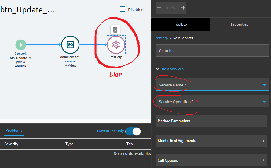

App Studio hides things. This is not a normal rest-erp / rest-kinetic.
There is nothing you can change here.
I mean you can try, but that will just make things worse.

Anyway, those options are not exposed in App Studio, so you can’t set them.
Of course, I did not accept that, so I tried to set them myself in the json…
Started looking in the abomination of javascript, and found I could change
erpBaqArgs.options.updateOptions.operation to UpdateBaqCustomAction
However, I could not figure out how to set the actionID. I tried everything, and the abomination was no help. If someone knows… @olga ? lol let me know.

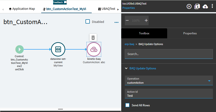

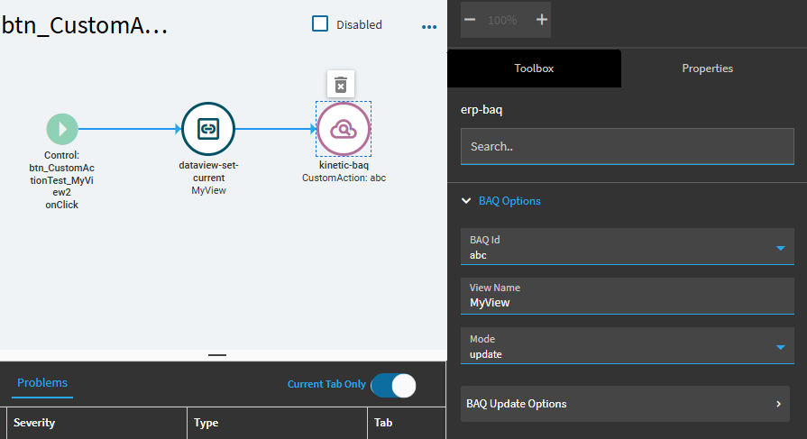

Way #1 → Kinetic-Baq widget (Has caveats lol)
Set BAQ Id to your BAQ
Set View Name to the dataview that holds your BAQ Data
Set Mode to update
Then on to the BAQ Update Options →
Set Operation to customAction
Set Action Id to your Custom Action Id

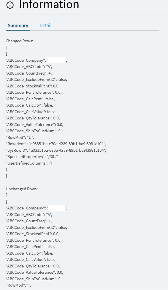

Now this has a caveat. It won’t send a Before Image.
Most things will still work, as some kind of EpiMagic Voodoo will create one for you on the fly.
However, it lies, as it just copies the updated row to one without a RowMod.
That means conditions like field has changed from won’t work properly.
See:
:dumpster_fire:

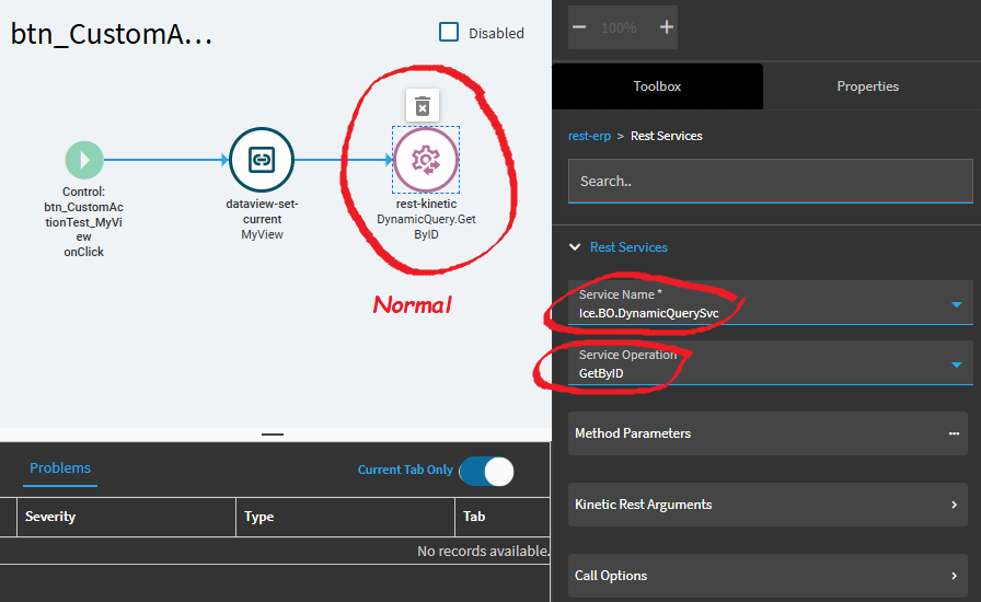

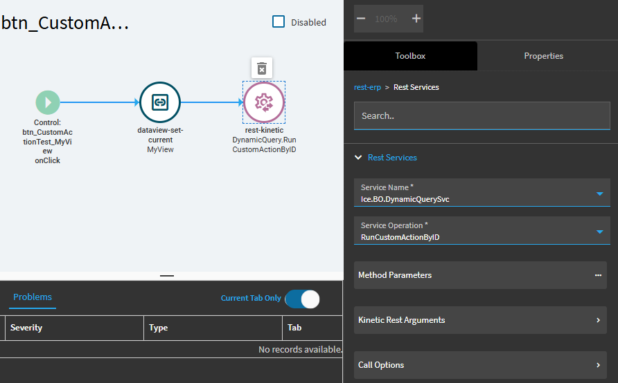

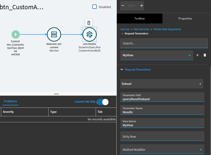

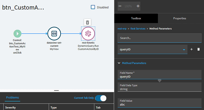

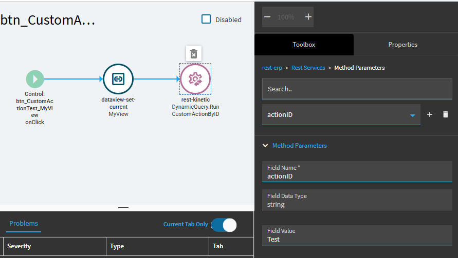

Way #2 → Rest-Erp widget (Has some weirdness, but works fine lol)
Set Service Name to Ice.BO.DynamicQuerySvc
Set Service Operation to RunCustomActionByID
Then move on to the Method Parameters:
Set queryID to your BAQ
Set actionID to your Custom Action ID

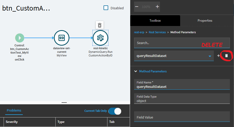

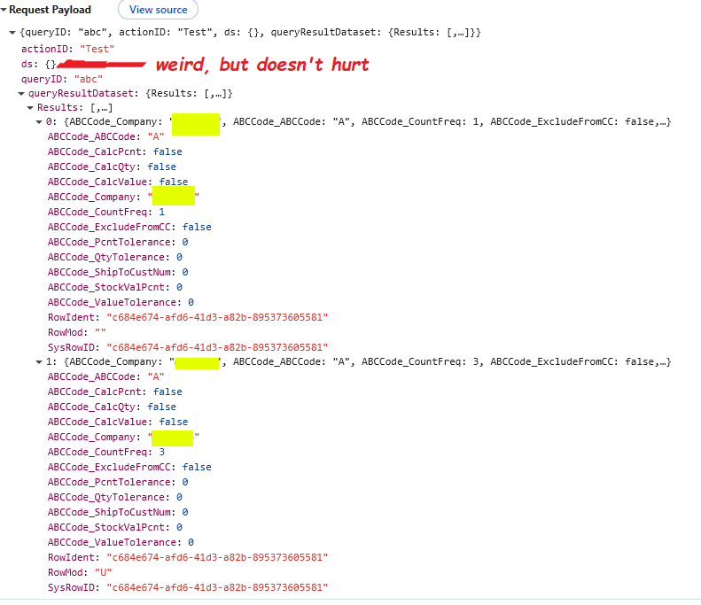

DELETE the queryResultDataset parameter!! Yes, bye bye.
Move on to the Kinetic Rest Arguments:
Set Parameter Path to queryResultDataset
Set Parameter Name to Results (almost got me lol)
Now for the wierdness, not really wierd, it just can’t be gotten rid of.
It will add an empty ds object, that will not cause any issues.
It is empty because we put our queryResultDataSet at the root, instead of inside ds.
(I can’t explain that well, don’t ask.)

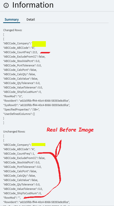

Notice this one has a PROPER Before Image
Done

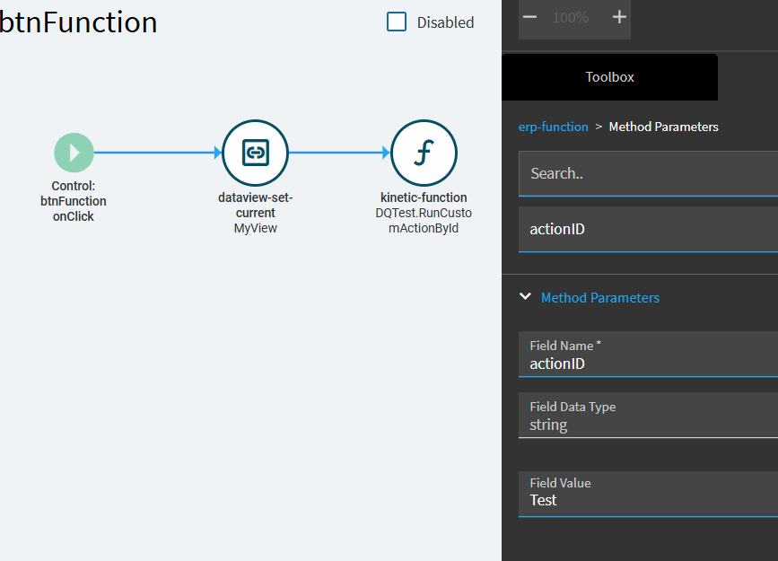

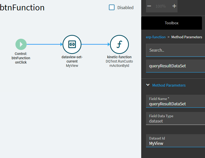

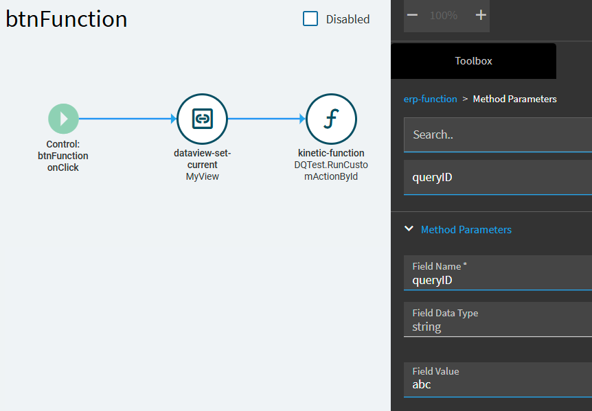

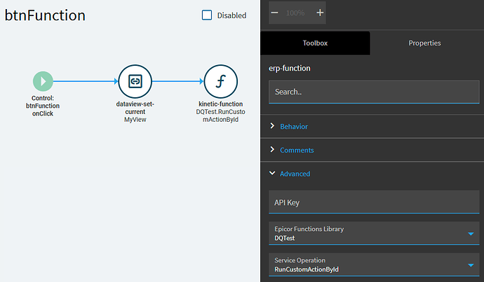

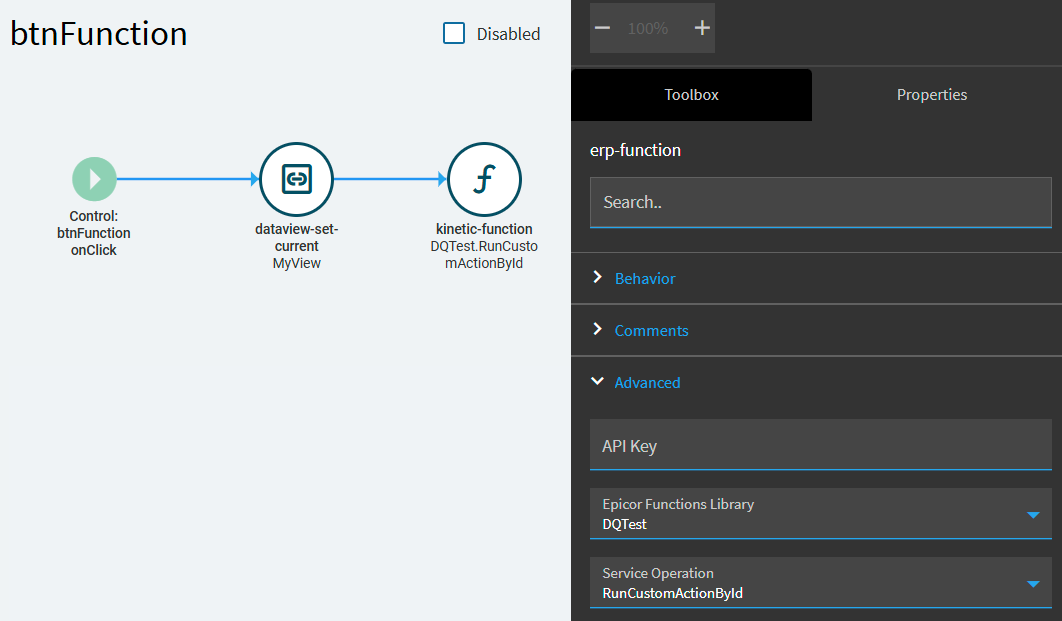

What about a generic function that takes the query result dataset baqid and action ID?
Is that any better? Probably not Bleh :nauseated_face:

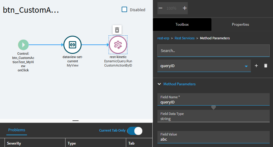

This should say: For the Field Name queryID, set the Field Value to your BAQ ID.
This is great! It works perfectly with my original code! Thank you for your volunteer efforts to make this extremely expensive software useable!
Was gonna do that next. Probably cleaner.
Just wanted follow the rabbit.

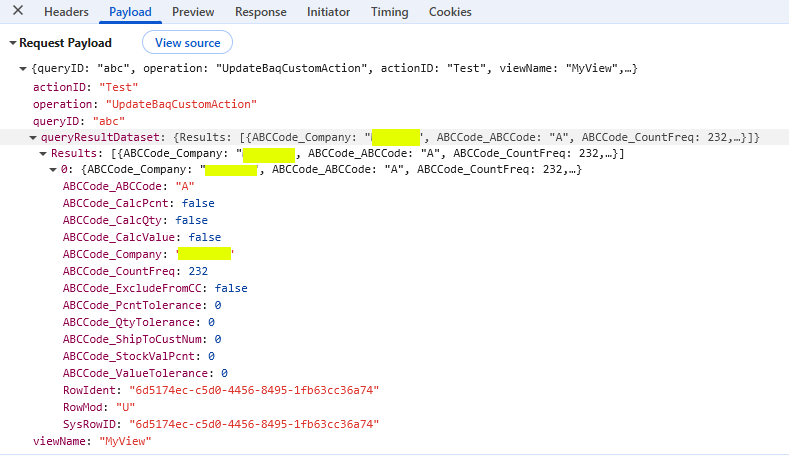

It DID!
    "id": "btn_Test_abc_0_0",
    "trigger": {
        "type": "Control",
        "target": "btn_Test_abc_0_0",
        "hook": "onClick"
    "actions": [
            "type": "rest-erp",
            "param": {
                "requestMethod": "POST",
                "erpRequestMethod": "UpdateBaqCustomAction",
                "erpBaqArgs": {
                    "baqId": "abc",
                    "options": {
                        "populateDataView": true,
                        "updateOptions": {
                            "operation": "UpdateBaqCustomAction",
                            "actionID": "Test",
                            "viewName": "abc_0_0"
So that’s nice to know, but unexposed properties is bad form.
At least we know what they are if you want to manually edit the json and do it like Epicor.

It is better.
CallService<DynamicQuerySvcContract>(dq =>
    Results = dq.RunCustomActionByID(queryID, actionID, queryResultDataSet);
I likes this much better! Nice job sir
