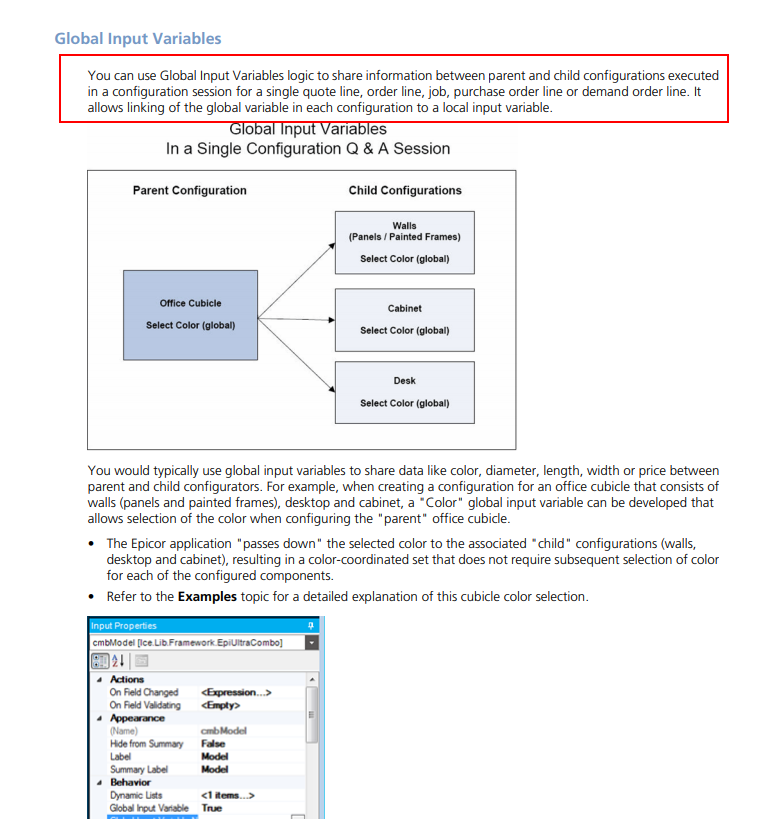

According to the manual you should use Global Variables to pass information between parent / child
I’m not that well versed in configurator, but from reading the other thread, I think you misunderstood what @Mark_Wonsil was trying to say. The Global Variable is a container to house some information. You can change the value of it while in the parent configurator value when you have the parent one open. Then when you open the child one, it would read that global variable. It sounds like that should work.
So why not create a global variable called “Label” or whatever. Then set the value of that on each of the parent configs and then use that value in your child.

@josecgomez I never said thanks for your contribution to this post and your screenshots of global variables. I appreciate it greatly! Thank you for your suggestions.
@Banderson thanks for your guidance as well, it is always good to re-think the process and ask ourselves if this is the best way. I still don’t know if it is.
