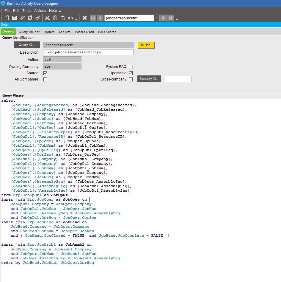

Can you show the BAQ source code and the table criteria in phrase builder? I was able to update fields at the resource level of all open jobs without issue previously. I know mine had to exclude any operations that had already started, but I didn’t have a null issue.

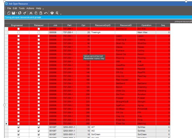

I need to clear out either the Resource group or Resource depending on which one i want to keep. We are having an issue with running the global scheduler and this is one known blocker, having both resource and resource group filled in. So when i upload my udashboard and edit the fields they come up red and say cannot be null

Im not sure how to display the source code in phrase builder and the only criteria we currently have on the whole BAQ is that the job is open

tried it again with prevent changes unchecked and i still received the same cannot be null error shown here

To display the source of BAQ look on the first tab in BAQ editor.

As for the source of the BAQ, do you all mean then Query Phrase?

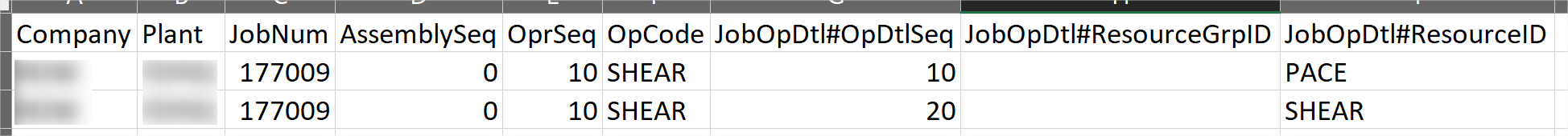

Here is a screen shot of the fields I included in my load to get it to work:
To Demo this I found an Engineered & Released Job and made sure one of my operations had resources that had both the resource group and resource defined on the same record. Then I used a BAQ to pull out only Open, uncomplete, not started Operations where the resource group & resource are not blank. Then I sent that to Excel, cleared out the Resource Group column and loaded it with DMT and checked the Job to make sure the change applied.
