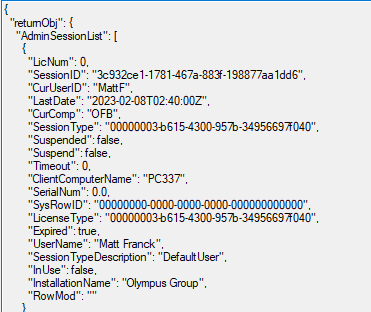

my results show like 25 of me that look like this:
I need to understand license usage, all these sessions seem to show the following:
- LicNum = 0
- Suspended = false
- Expired = true
- InUse = false
Looking for how do I identify active license usage ?
