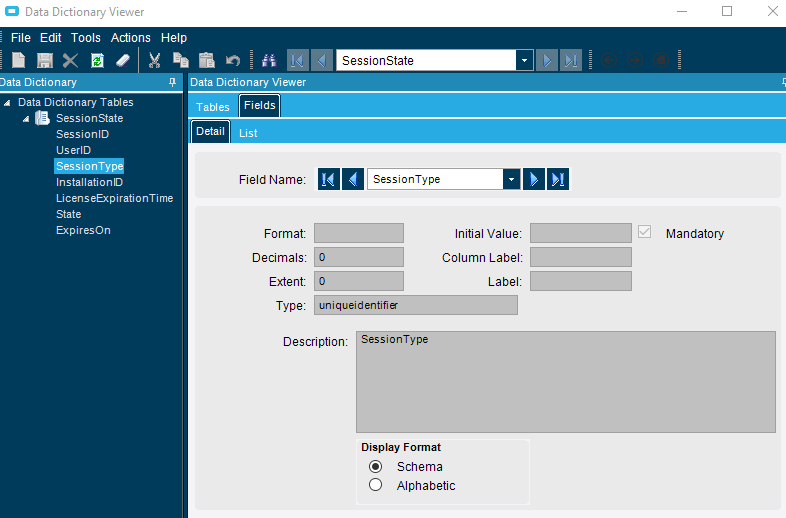

@AlekseyN (or anyone) - What is an EnterpriseProcessing license? We’ve got this working, but I’m not clear on what those license types are. Sometimes I’m on that list of users that have it, other times other office (aka DefaultUser). Usually it’s just a handful of users.
Do EnterpriseProcessing users get counted against our Office licenses? Or DataCollection? Or they just exist, and don’t get counted for anything? Or Related to Enterprise Search?
I found the UserTracker dashboard and Epicor Help articles, but they don’t explain the SessionType column.
Thanks!
Hey @askulte, check out KB0047344 - License Type Utilization in Epicor ERP 10
Thanks, Scott!
  • Enterprise Processing: any secondary session started from a Default session. This session type does not consume a licence. For example, switching companies in the application will start an Enterprise Processing license for the secondary session. If Service Connect is invoked from a BPM (Business Process Management) it will start an Enterprise Processing session.
