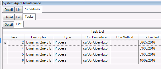

I’ve got 4 BAQ Exports set on a schedule, and one is showing errors in the log file.
How can I tell which Scheduled task is for which BAQ Export?
I can’t seem to to get the “Task Param” column to show in the System Agent program.
The grid I’m talking about is:
I’ve just both personalization and customization. But the “Task Param” column reverts to hidden each time the form is reloaded

Try this…
System Mgmt --> Utilities --> System Agent -->
  • Open your System Task Agent
  • Find your scheduled task(s)
  • Schedules --> Tasks --> Detail sheet
    — Actions menu: --> View Task Parameters
