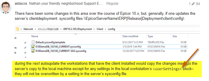

You make the changes to the server’s sysconfig files, and during the next autoupdate the changes will be pulled down to the workstations.

The local sysconfig files would need to be manually adjusted on the workstations in that situation.
When I changed the sys files on the server, it did not update.
Probably because in my shortcut, I dont have the -auto in there?
C:\Epicor\ERP10.1Client\Client\Epicor.exe /config=Production-E10.sysconfig
when Installing EPICOR, is there a flag to set the shortcut that way?
ALso, I did the custom folder process, and it did update the workstations, but I had to manually update the servers (terminal servers)

Will these local changes (in SaaS environments) need to be redone after updates? The one I’m thinking about in particular is the DocStar signon prompt. By default, it’s commented out in sysconfig but as Cloud DocStar users, the default should be 'Interactive" and I wonder if we would have to go around once a month or so and reset them all if not preserved. (We noticed some items appear to be overwritten after updates.)

If the setting is moved or already located in the usersettings block on the local workstation’s sysconfig it will persist and not be overwritten by what is in the server’s sysconfig for that setting.
