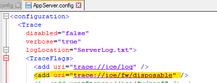

    There can be real memory leaks - both in shipping code as well as in BPMs, functions and the like. In normal usage, these will get cleaned up at the end of a server call. All server objects are cataloged and we iterate through to ensure no one has done something bad. The Disposable trace will note that for you
    An example of this scenario is as follows. An warning that the framework cleaned up an undisposed class after the previous operation.
