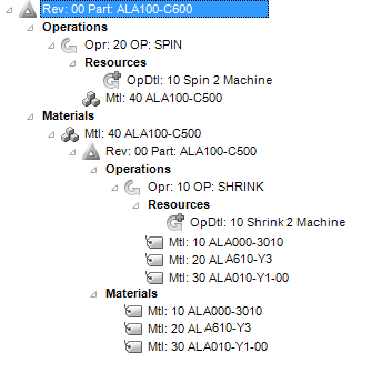

I posted awhile back about some discrepancies, and thought I might have solved the problem, but I don’t think this is the case now. I’m setting up what should be a simple method for the production floor. Basically, Operation 1 consumes 3 material pieces and moves to the next operation. Operation 2 consumes the sub assembly produced by oepration 1, and puts the produced part into inventory.
All these parts are set up as using 1/EA for the method.
Track Lots is enabled, Auto move is enabled. I’m not understanding how Epicor does the calculations or why it seems to look wrong. I ran the system process to recalculate the PartOHQty yesterday (this took awhile) and it still seems to look off.
Here are some of the steps taken below:
Method:

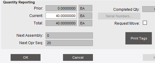

When using the Report Qty in MES, it only seems to relieve a single piece of material, instead of all 3.40 pieces reported:
AutoMove is set up under the operation I believe.
PartWIP:
No Changes to PartTranReport Qty for next operation (Final operation, Auto Receive to Inventory)

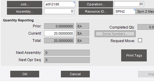

PartWIP:
Previous operation produced 40 pieces into WIP, reported 20 for next operation, all pieces in WIP removed
