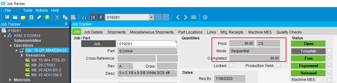

I show 56 reported on the only operation we have and that ties with completed qty as you would expect

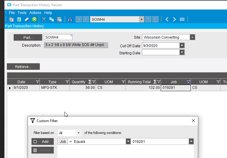

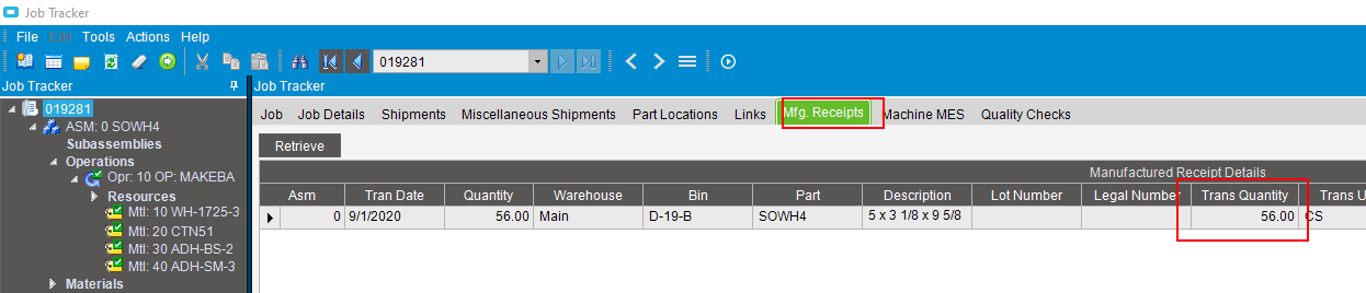

There is only one receipt and it’s for the full pallet of 56 as we would expect. I confirmed in Trans Tracker

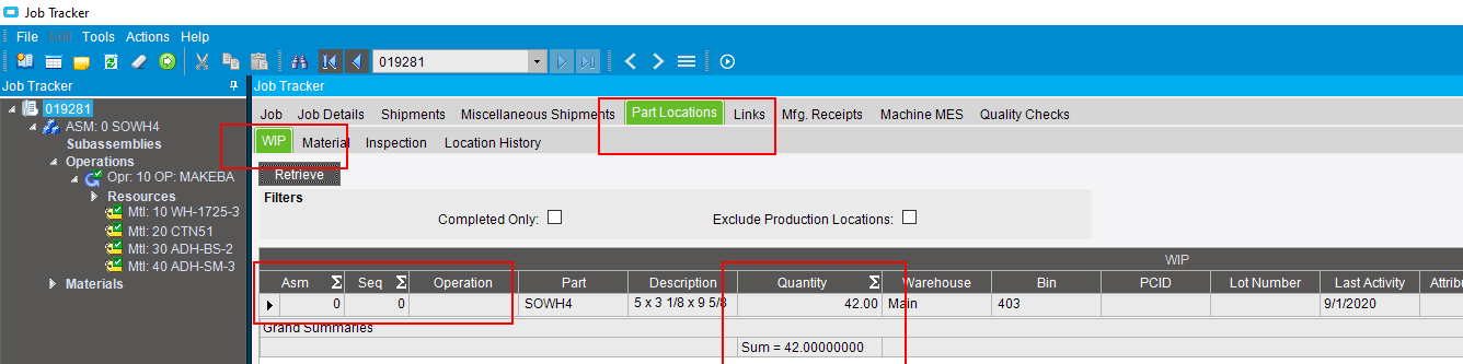

However there are still 42 in WIP at the assembly level. I can’t even wrap my head around 42 because it’s not even a number that matches any other transaction.

If AMM allows WIP to be tracked in a Bin, then maybe the “Refresh PartBin QOH” process would clean it up. There is a “Report Only” option you could run.
The qty in bin is still tracked in PartWIP and there are no transactions for WIP so by it’s name I assume there would be no impact, but i’ll run report anyways and see what we get.

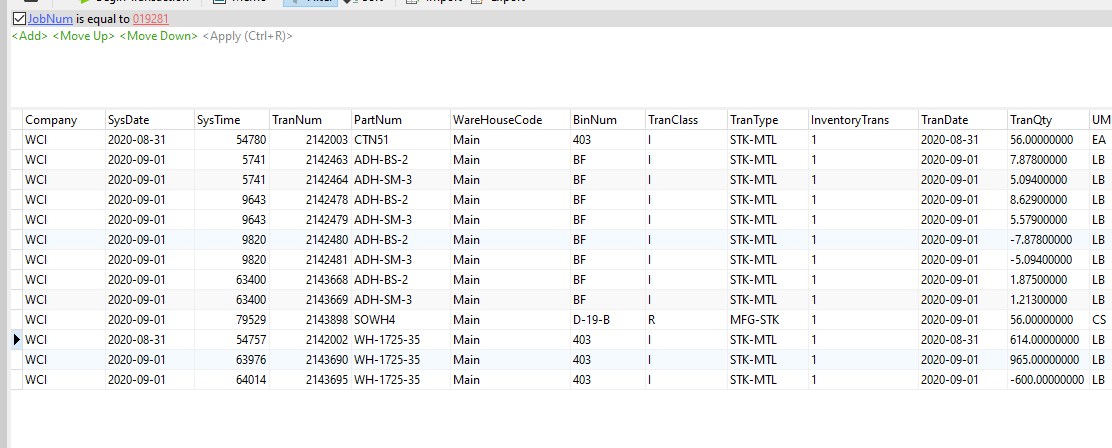

Set your Cut off date to 1/1/8999 – see if its one of those where someone fat fingered a future TransDate.
Happens quite often for us when someone does Qty Adjustment – they accidently start typing in the TransDate field the part number and before you know it they posted inventory into the year 9999 and Epicor deducts it from current Inventory and throws off reports.
It would still show up in job tracker.
why not 12/31/8999 just to be sure? :wink:
No dice. Just some crappy backflushed materials in the report nothing else.
John Susil said the same thing, until it didn’t :innocent:
Here all part tran for that job. There are no additional transactions I assure you.
