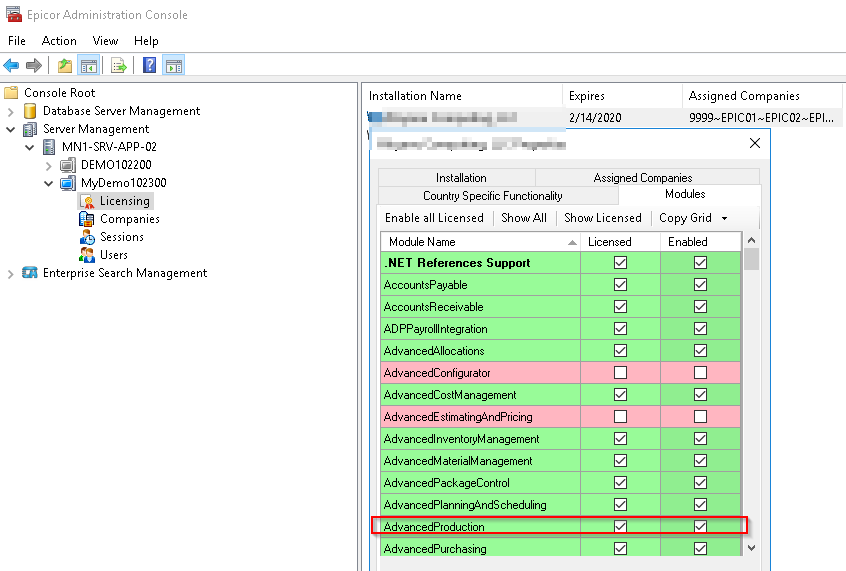

@Stevensi1018 - Do you have the Advanced Production license?
I don’t know what that is. How can I look into it ?
If you open your Epicor Administration Console you can go under your application server – licensing and then open the license. You will see if the module is enabled and/or licensed.
Thanks, I don’t have the license. How can I replicate the ā€˜Make to Order’ via the REST API then ? Is there another API call (Update?) that I can use ?
