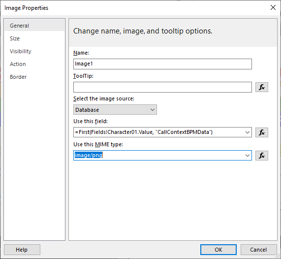

Then you can do this:
In the report, add a DataSet, call it CallContextBPMDataOrSomethingLOL
  • Use a data source in the report.
Query expression →
  SELECT T1.Character01
  FROM CallContextBPMData_" + Parameters!TableGuid.Value + " T1"
Add a field for it.
Then add the image and set it up like this:
