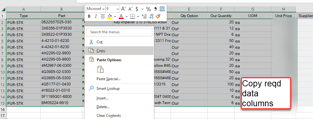

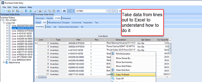

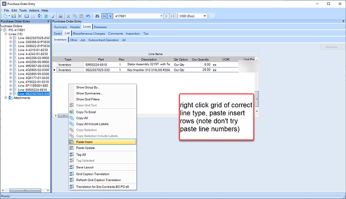

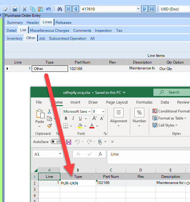

Another option is pasting lines. One drawback I am seeing with this might be the lack of gl account assignment on the release, but IDK if that’s really a problem or it will just default correctly from part class although it’s not obvious on PO. See screenshots for how to get / paste line data. I like to export the data from a known PO to Excel, eliminate what I don’t need to upload from the columns and reorder in the Line grid of the PO to be in same order as the paste from data.

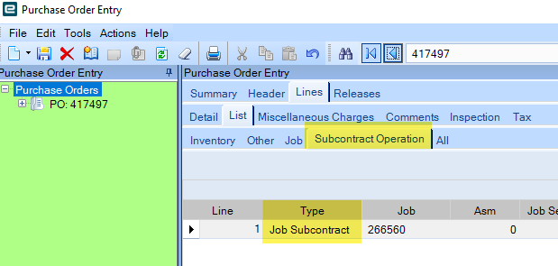

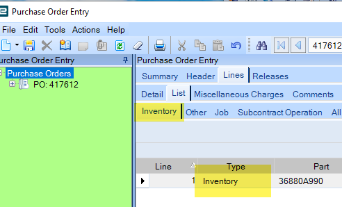

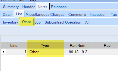

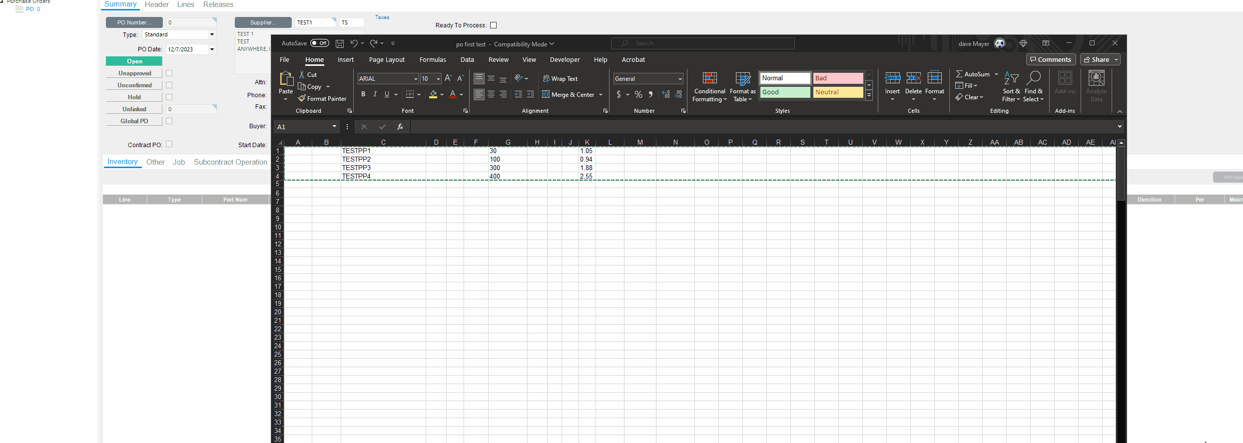

Well unfortunately the lovely insert trick didn’t work:-( Each new line wanted to go to the wrong Type no matter that I had which Type it was supposed to hit. Kept erroring. Oh well, he’s going to have to enter manually.
Thanks again
Did you ensure paste on correct tab as well as correct entry into type, i.e., inventory, Job Subcontract, Other…?
Yes absolutely did that. Not sure why didn’t work.
If you want to paste it in the type works like line, leave that column blank. The description, Qty Option, UOM, Supplier QTY, and Supply UOM also can be left blank.
