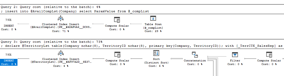

The two items that make standard BAQs slower than external BAQs are normally the two table valued variables that are created for security. If you look at the query execution plan from the BAQ designer you can see the first thing it does is create a fill two variables. The company list is for company security and is often ignored by SQL by setting Company = CurrentCompany on your first table. The TerritoryLst table is brought in for order and customer security. It can be removed by unchecking “Territory Security on Sales Orders” in Company Config.
The other piece that can make the standard BAQ slower is I think it will always use the dbo view if there are custom fields.
I always try to make the standard BAQ work before jumping to an external. They don’t work as well in dashboards without a bunch of extra work and they are confusing if you aren’t expecting them.
As an example this:
select
	[OrderHed].[OrderNum] as [OrderHed_OrderNum],
	[Customer].[Name] as [Customer_Name]
from Erp.OrderHed as OrderHed
inner join Erp.Customer as Customer on
	OrderHed.Company = Customer.Company
	and OrderHed.BTCustNum = Customer.CustNum
turns into this:
Expand the summary to see the mess…
Summary
(@_compList [Ice].[QueryParamTableType] READONLY,@CurrentUserID nvarchar(max) ,@CurrentCompany nvarchar(max) )
declare @AvailCompLst table(Company nchar(8) primary key);
insert into @AvailCompLst values(N'')
insert into @AvailCompLst(Company) select ParamValue from @_compList
declare @TerritoryLst table(Company nchar(8), TerritoryID nchar(8), primary key(Company, TerritoryID));
with [_TerrCTE_SalesRep]  as
    select uc.Company as Company, sr.SalesRepCode, ISNull(sr.ViewAllTer,0) as ViewAllTer, (case when em.FeatureID is null then 0 else 1 end) as TrCrAllowed
    from [Erp].[UserComp] uc
        left join [Erp].[SaleAuth] sa on sa.Company = uc.Company and sa.DcdUserID = uc.DcdUserID
        left join [Erp].[SalesRep] sr on sr.Company = uc.Company  and sr.SalesRepCode = sa.SalesRepCode
        left join [Ice].[SysCompany] sc on sc.Company = uc.Company
        left join [Ice].[EnabledModule] em on em.InstallationID = sc.InstallationID and em.FeatureID = '00000003-9662-4B1D-AD67-8D90C3599092'
    where
        (uc.Company = N'' or uc.Company = @CurrentCompany) and uc.DcdUserID = @CurrentUserID
insert into @TerritoryLst
select st.Company, st.TerritoryID -- CRM disabled
from [_TerrCTE_SalesRep]
inner join [Erp].[SalesTer] st on st.Company = [_TerrCTE_SalesRep].Company and st.Inactive = 0
where [_TerrCTE_SalesRep].TrCrAllowed = 0
union
select st1.Company, st1.TerritoryID -- CRM enabled and ViewAllTerr=1
inner join [Erp].[SalesTer] st1 on st1.Company = [_TerrCTE_SalesRep].Company and st1.Inactive = 0
where [_TerrCTE_SalesRep].ViewAllTer = 1 and [_TerrCTE_SalesRep].TrCrAllowed = 1
union
select st2.Company, st2.TerritoryID -- CRM enabled and no SaleAuth
inner join [Erp].[SalesTer] st2 on st2.Company = [_TerrCTE_SalesRep].Company and st2.Inactive = 0
where [_TerrCTE_SalesRep].TrCrAllowed = 1 and not exists(select top 1 1 from [Erp].[SaleAuth] sa2 where sa2.Company = [_TerrCTE_SalesRep].Company and sa2.DcdUserID = @CurrentUserID and sa2.SalesRepCode = [_TerrCTE_SalesRep].SalesRepCode)
union
select strp.Company, strp.TerritoryID -- CRM enabled and ViewAllTerr=0 and territories assigned
inner join [Erp].[SalesTRP] strp on [_TerrCTE_SalesRep].ViewAllTer = 0 and [_TerrCTE_SalesRep].Company = strp.Company and [_TerrCTE_SalesRep].SalesRepCode = strp.SalesRepCode
--queryid: test, query companyid: EPIC06, userid: epicor, user companyid: EPIC06
--baqd39da1ed6-f162-43e9-a92c-6c8f4059fded;
SET DATEFORMAT mdy;
select [OrderHed].[OrderNum] [OrderHed_OrderNum],[Customer].[Name] [Customer_Name]
from ( [Erp].[OrderHed] inner join @AvailCompLst [AvailCLst_OrderHed] on [OrderHed].[Company] is null Or [OrderHed].[Company] = [AvailCLst_OrderHed].[Company])
inner join ( [Erp].[Customer] inner join @AvailCompLst [AvailCLst_Customer] on [Customer].[Company] is null Or [Customer].[Company] = [AvailCLst_Customer].[Company]) on ([OrderHed].[Company] = [Customer].[Company] And [OrderHed].[BTCustNum] = [Customer].[CustNum]) and ((([Customer].[TerritoryID] is null or [Customer].[TerritoryID] =  N'') or  exists (select 1
from @TerritoryLst [__TerritoryLst]
where [__TerritoryLst].[Company] = [Customer].[Company] and [__TerritoryLst].[TerritoryID] = [Customer].[TerritoryID]
) or  exists (select 1 [c1]
from [Erp].[ShipTo] [ShipTo]
inner join @TerritoryLst [__TerritoryLst] on [ShipTo].[Company] = [__TerritoryLst].[Company] and [ShipTo].[TerritoryID] = [__TerritoryLst].[TerritoryID] Or [ShipTo].[TerritoryID] is null  Or [ShipTo].[TerritoryID] =  N''
where [ShipTo].[Company] = [Customer].[Company] and [ShipTo].[CustNum] = [Customer].[CustNum]
