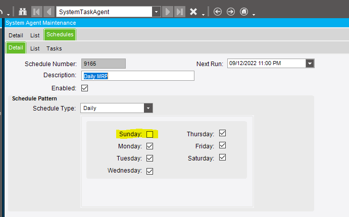

I have two different schedules for running MRP. 6 days a week, it’s a net change and on Sunday, a regenerative one is run. That’s how it is scheduled and that is how it has run until two weeks ago. Now the one scheduled to run 6 days a week has decided it will run 7.
Last night it kept my regen one from running as that one errored because this one had already started. Workaround is I just moved the other one up 15 minutes so it will already be running when this one starts again next Sunday. Any ideas why this would be occurring? I have not changed anything with either of these scheduled tasks in months so not really certain why this started or even what could be causing it.

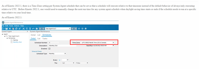

This has come up here before. Against any sane logic, it reads the date as local and the time as UTC (GMT/Zulu/London/etc.) and you get some really wacky results.
Thanks for the response Jason. That’s a pain but can be worked around. Appreciate your time
Epicor has given you at least one reason to upgrade to 2022.1+:
From EpicCare: Scheduled Tasks are not running at intended time after Daylight Saving Time changes)
