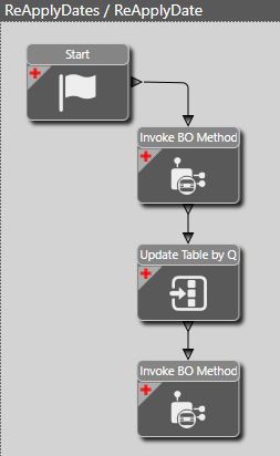

Following the instructions on the post below I’m trying to recreate their bpm as a function:
Here is what I have so far:

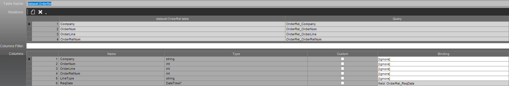

The first invoke bo method calls the Erp.SalesOrder.Update. The Update table by query used the OrderRel table with the criteria of open releases = true and firm releases = true. I have it updating all rows of dataset.OrderRel with the following configuration:
The last bo method is the same as the first.
@Aaron_Moreng @hkeric.wci
Question:
After running the process I get no errors, but I have little to no way of seeing if the data was actually pushed/updated. Nor does it appear that any significant changes were made as the data looks correct in order tracker and within the data table, but does not show correctly within Job Manager. What can I do to help troubleshoot through this update process and see the data that should be loaded into the table? What am I doing wrong when invoking these bo methods?

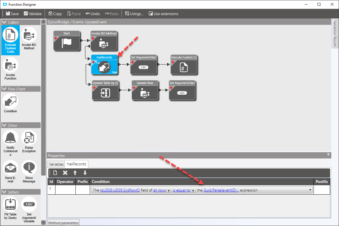

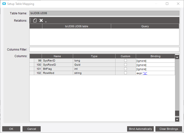

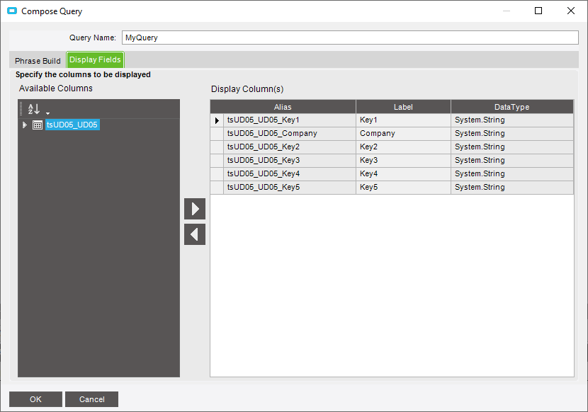

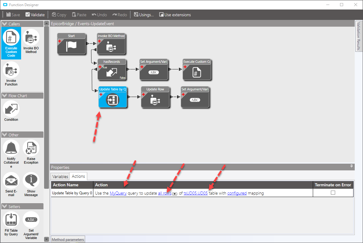

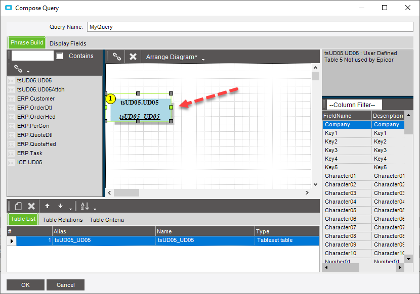

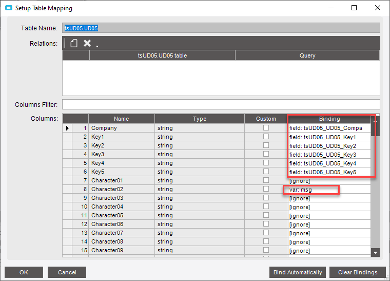

Here’s how I have used the Update Table by Query widget:
First, I use a designed query to select the record from the tableset variable I am working with
I display the appropriate fields to select a single record
In my case, I am updating all rows of the table set. Then, in the configured mapping, I am finding the record with the query values and setting my variables in this with the bindings

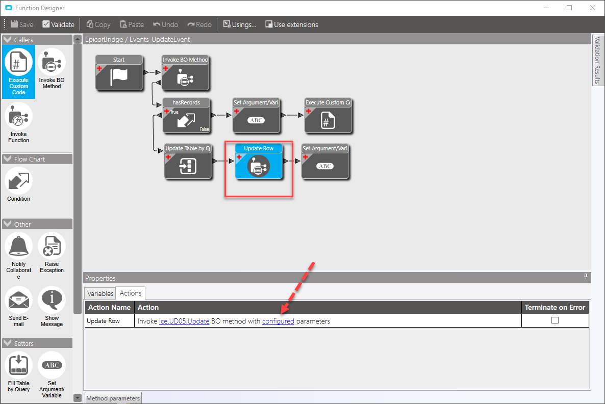

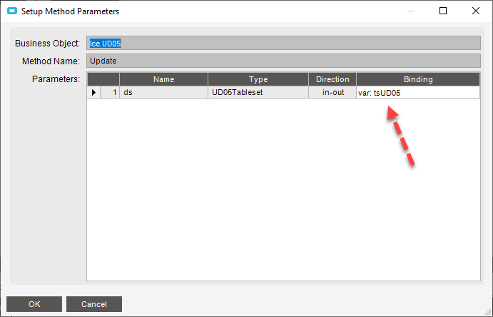

What this is doing is modifying the tableset variable. Then, you need to call the Update BO and pass in the modified table

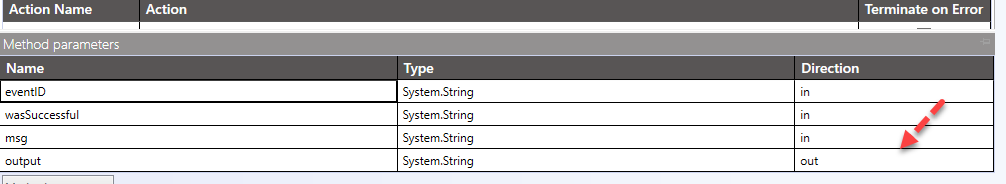

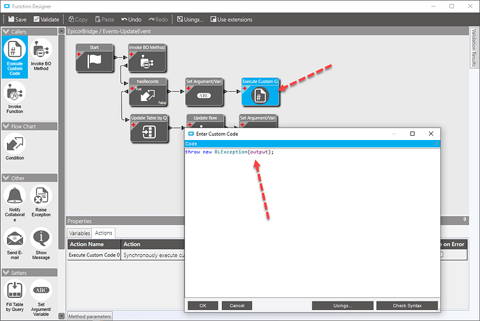

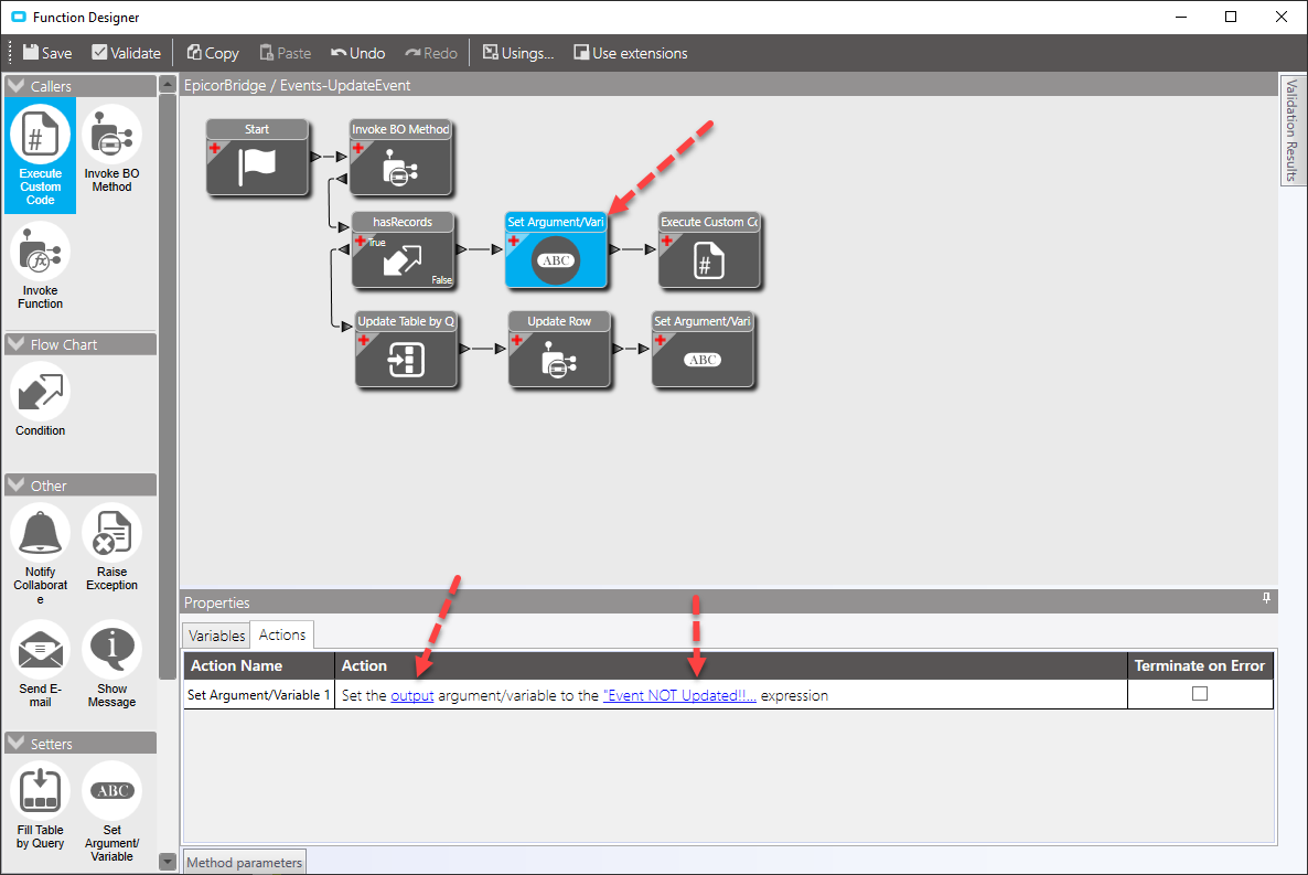

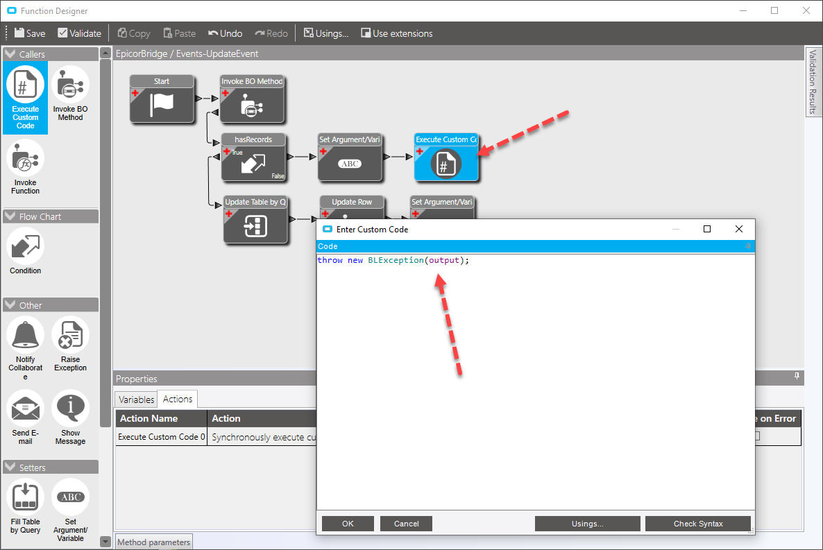

For debugging and/or confirmation of success/failure in a function, I create an “output” variable as part of the method Out parameter signature and I set this variable inside my BPM
Here is an example of me checking my GetByID method return to evaluate if I found a record. If I don’t, I set my output variable to an error and I throw an exception. You don’t have to throw an exception, but you can.
Conversely, you can do this for success too and set your output variable(s) to “success” or whatever tells you it went through ok.
@Aaron_Moreng
How do I add those method parameters? I see the button on the bottom left, but it doesn’t have an add a new button or anything.
EDIT:
Additionally, what is the last set argument for and what does your first invoke method look like? Where do we set the value for eventID? Thanks a ton!
You’ll define those parameters on the function level, if that is indeed what tool you are using. If this is just a BPM, you can create variables as well but it’s a little different.
The last set argument is to set my local variable equal to a value I determined. You don’t need that to do a table update, it’s just to demonstrate how to utilize local variables for confirming and communicating outside of your BPM
In my example, eventID is a function variable that I pass into my function.
So instead of checking eventID could I instead check to see that sysrowid isn’t blank? I went ahead and filtered my baq results down to a single order release so that I can visibly see when it goes through.
I am building it on a function. Just never saw where I could define parameters.
Yep. I’ll post a screenshot in a while of what/where to define those if you’re still looking
