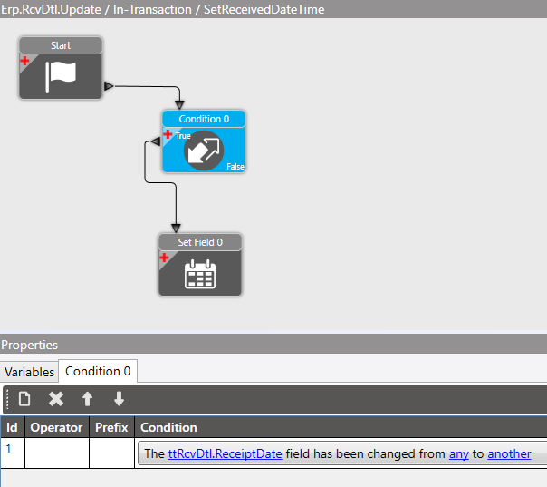

Erp.RcvDtl.Update / In-Transaction / SetReceivedDateTime
I’m setting the ttRcvDtl.ReceivedDateTime_c field of the changed row to the BPmFunc.Now() expression
on the condition that ttRcvDtl.Received field has been changed from False to True. However, the condition isn’t being met properly.

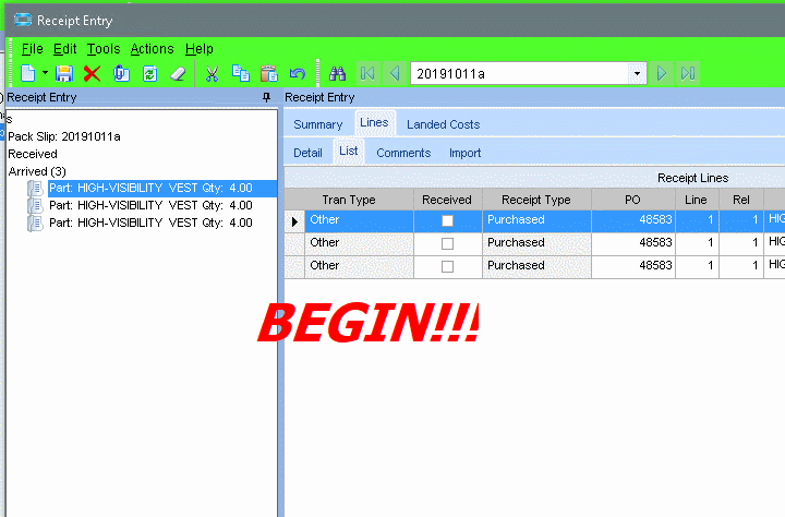

I’m suspecting that this one doesn’t work so simply because there are multiple rows and I need to get to the right row. I added a Show Message on the False condition that supports that thought. Can I add a condition or something to get this to work? Or do I need to get into custom code for working with Receipt Entry / New Receipt Line and the RcvDtl table. I just want to detect when the Received check box is checked (see screenshot).

Hi @Chris_Conn That didn’t work for me…Triggering off ttRcvDtl.ReceiptDate change only worked one time yesterday and there have been more ReceiptDate values of today. Actually, I had that same behavior when I used ttRcvDtl.Received as the trigger. We are on 10.2.300.15.

The DD will trigger once for each row. You don’t need to loop through anything. One thing that might be throwing you off is that the RcvDtl table is not updated when you change rows in Receipt Entry. Not until you make a save are all the changes written.
In the GIF below I change the Received flag on each receipt line, but the DD only triggers once I save it. And then it triggers once for each row. Had I not set Line 3 as received, only lines 1 and 2 would have triggered.
Also notice that I was able to set the ReceiptDate (it shows the time of day instead of just 12:00:00 AM)
