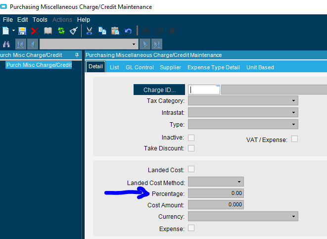

In the landed cost master you can specify the percentage.
Add them in the receipt entry as indirect cost and disburse the landed cost based on VALUE.
There is also a Material burden percentage available at the part level. This will add a freight estimate to certain parts as needed. These estimates can be put to a GL account.
The freight actual expenses can then be pointed a second GL account to give you a overall picture of the estimate vs actual.
The landed cost module will do more that this.
