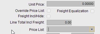

Short answer is that we use this as a ‘smoke and mirrors’ kind of thing. We do not interfere with ANY of the core processing, until the excess ‘cash’ is received. That excess is coded to the freight expense account, but that is the same account that our AP invoices are coded to when we pay the freight.
We did this little UI customization to allow the entry person to indicate:
  • Line Total Incl Freight - the amount we’ll show on the paperwork
  • Freight Incl/hide - is the trigger to make the change on the paperwork.
Ignore the Freight Equalization checkbox - it’s for I/C reporting only.
NOTE - We also have a modified Sales Report to ‘remove’ the including freight. Effectively we create a new column called Revenue ADF (after deducting Freight) which account for all included or separate freight lines and Misc. Charges. This gives you a clear product sales report with NO freight included.
I came up with this about 20 years ago for my previous gig and is working great! I really need to put an Epicor Idea in for this since Epicor has NEVER considered ‘freight included pricing’ as an option. It’s a rabbit hole of landed costs, post receipt freight bills, post shipping freight bills, burden or pass-thru, blah-blah.
