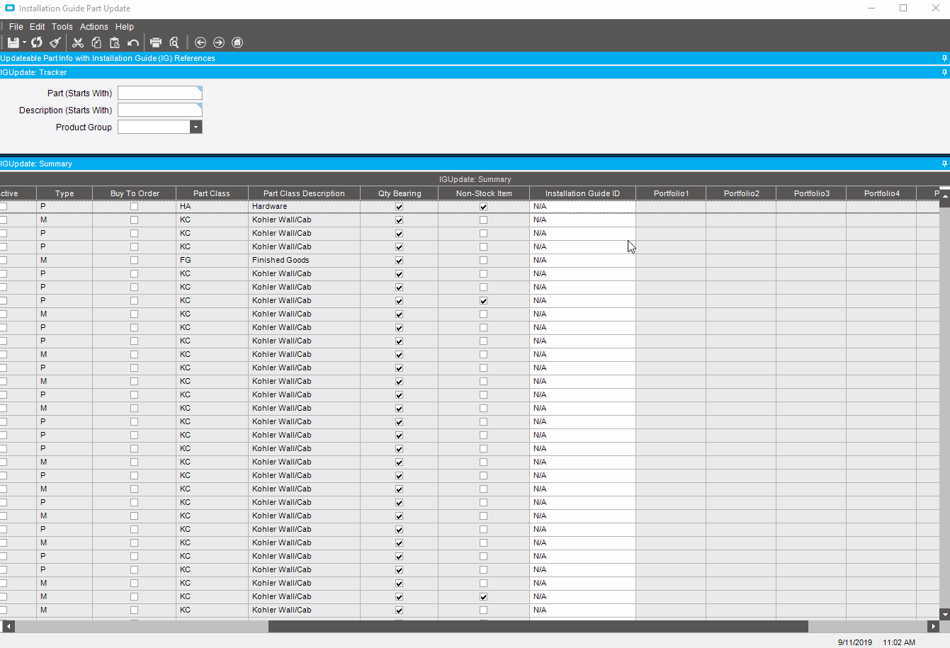

Indicate Dirty rows on Update-able Dashboard
Is there a way to highlight rows in an Updateable dashboard (with multi-dirty row enabled), that have been changed, but not yet saved?
I’m okay if “changed” row that was changed, then changed back to the original values, is highlighted - even though the new values are the same as the old ones.

I did this with a UI customization (used the wizard).
	private void CreateRowRuleV_IGUpdate_1ViewPart_InstallGuideID_cColumnValueChanges()
		// Description: Changed
		// **** begin autogenerated code ****
		RuleAction warningV_IGUpdate_1View_RowAction = RuleAction.AddRowSettings(this.oTrans, "V_IGUpdate_1View", true, SettingStyle.Warning);
		RuleAction[] ruleActions = new RuleAction[] {
				warningV_IGUpdate_1View_RowAction};
		// Create RowRule and add to the EpiDataView.
		RowRule rrCreateRowRuleV_IGUpdate_1ViewPart_InstallGuideID_cColumnValueChanges = new RowRule("V_IGUpdate_1View.Part_InstallGuideID_c", RuleCondition.ColumnValueChanges, "V_IGUpdate_1View.Part_InstallGuideID_c", ruleActions);
		((EpiDataView)(this.oTrans.EpiDataViews["V_IGUpdate_1View"])).AddRowRule(rrCreateRowRuleV_IGUpdate_1ViewPart_InstallGuideID_cColumnValueChanges);
		// **** end autogenerated code ****
