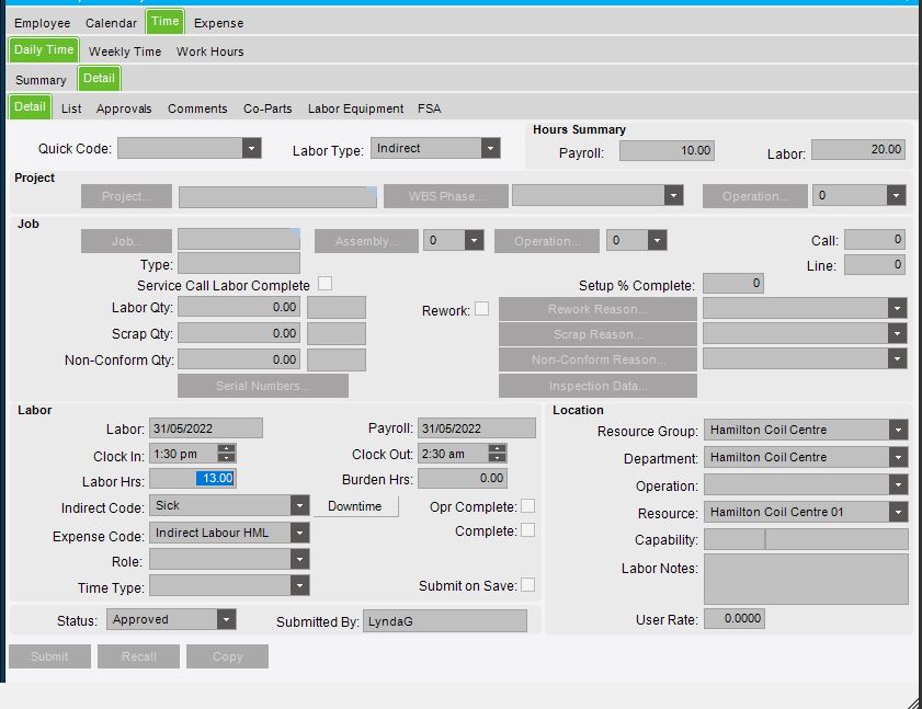

Hello everyone, I’m just new with Epicor. I just wanted to know if there is a way to adjust indirect labor, labor hours entered was 13hours instead of 1hour.
If the hours are entered on a Job as direct labor, we can use the job adjustment tool but how about for indirect labor?

Click on the Recall button and you should be able to edit it. (Just make sure to do it before the date the transaction occurred on is posted.)
Hi Chris,
Thanks for your reply, I’m aware of the recall button. But, is there a way to adjust it once it is posted? So that the journal in the system will not increase the labor costs in the books?
No once posted you can’t change it
Finance will have to adjust in their side if they want to
Try new entry with -12, see if system allows it.
Thanks for the suggestion @josecgomez
It doesn’t allow me to input negative hours.
