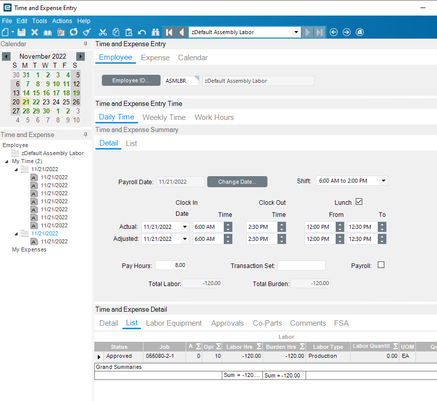

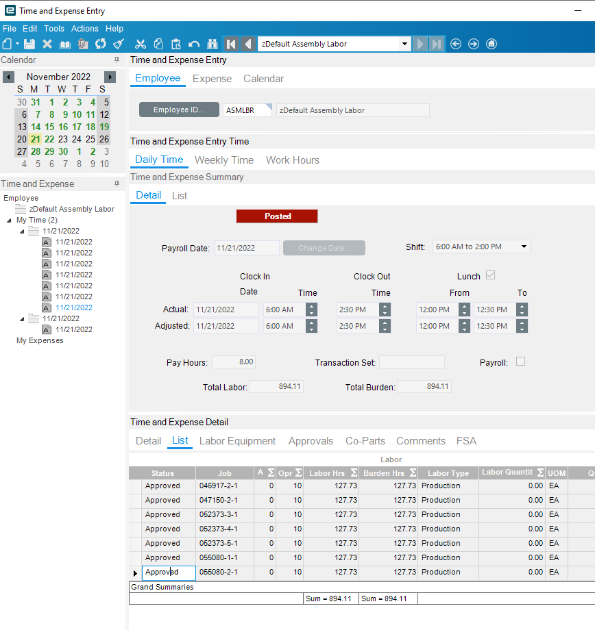

This is actually not true - there is one more way. Sorry @timshuwy
Fun fact: You can enter negative hours on a job.
I learned this from a user who didn’t know that he couldn’t do this, so he tried it and it worked. ![]()
Naturally the job has to be not-completed, but that’s true of any of these scenarios, right?
The catch, though is that you can’t put negative hours on something that had none to begin with.
To spell that out, I can do -8 hours for employee JSmith on job 123456 op 10 only if job 123456 op 10 already has 8 or more hours for JSmith.
And yes, the previous labor was posted.
I never like negative labor… but i get it. that would correct the time.
