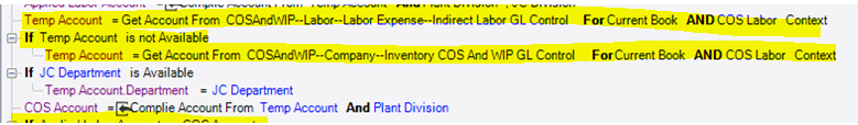

They are probably being net 0 balanced in Applied Labor. Take a look at this.
Thank you Joshua. We reviewed the GL accounts and found that a change to the Applied Labor account wasn’t saved properly. This was in fact balancing to 0 in applied labor.
