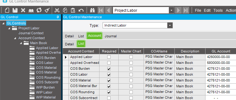

When you create the Expense Codes you can assign a GL Control of type Indirect Labor. I believe if you set the Applied Labor and COS Labor account contexts on that GL Control to the same account, any GL transactions that are created will offset for $0 net effect. I think Epicor won’t even post anything to the GL if you have the COS/WIP posting rule set to summarize.
In our case, we have the credit portion of the GL transaction offset our direct labor applied account and charge an Indirect Labor account. This reflects the cost of having direct floor employees doing indirect work for us.
That makes sense to me. And I can see why we might want to have it as two separate accounts. We just aren’t currently setup that way. But the goal is the same. We want to minimize “skilled” labor spending time doing things that a general laborer could do.
