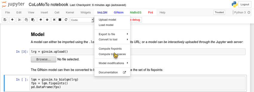

Something that has piqued my interest are Jupyter Notebooks. Microsoft has them now for SQL Server 2019. Jupyter Notebooks got their start with people doing Data Science in Python. They are a combination of markdown (which this site uses) with Excel cells.
Do imagine walking through a document and running SQL code at the same time. For Epicor, this would be a FANTASTIC way to distribute SQL instructions for users who need to create an Epicor database. Instructions and code together.
The not-ready for primetime feature are .Net Notebooks. This means we can run .Net code in a Notebook, which means we can call REST from a Notebook, which means we can do Epicor Transactions. Think of the process of doing a payment run in Epicor. You have the documentation and the code together of which the results are saved all in the Notebook! The Group, the Edit List, etc. all in one place. Rules can be added to do extra business rule checking too. I think this is going to be very powerful by next year.

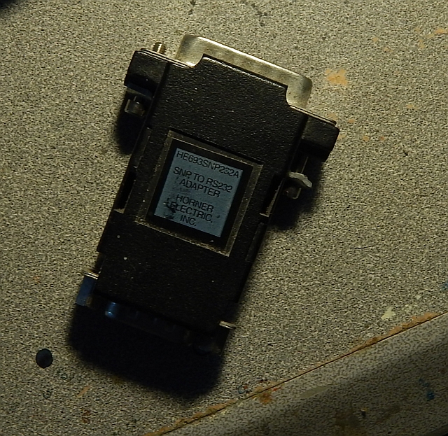

Nice… how far things have come.
I still keep my SNP adapter handy though, just in case. I think it was one of Horner’s first really successful products.
