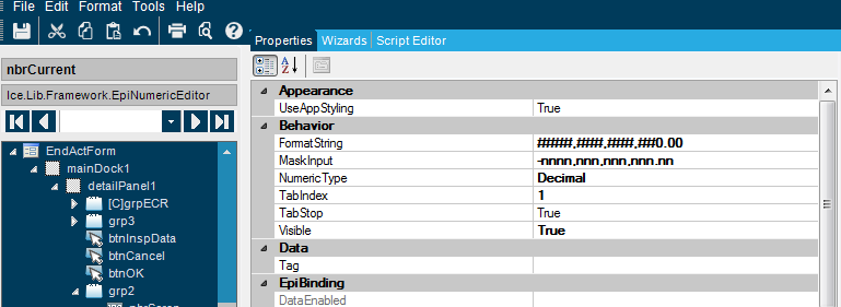

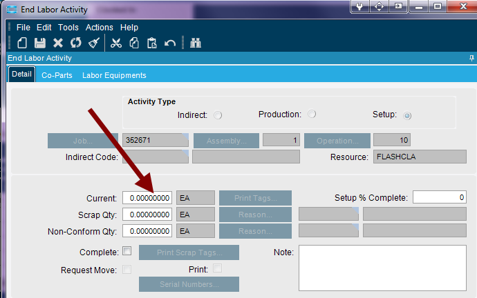

I can’t get this input box to have only 2 decimal points. Every time I save it, it reverts back to too many zeros. How do I create a customization that sticks?
too-many-zeros
I change this and then clear cache and relaunch but it always reverts back.
This is the format I want:

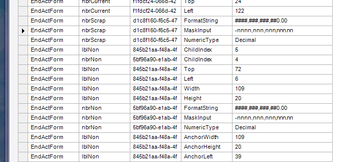

Even the XML Editor says I have the correct mask values.
xml
The control is probably being overridden by extended props of the dataview.
How can I investigate that? What are Extended Props of the Dataview?
