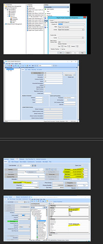

Hello,
Hopefully this is something that is simple that we are just overlooking. As an example, in Order Entry most of the quantities (say on the line tab) display eight decimal places. Our Company settings in Epicor Admin Console and in Currency Master are set to lower than that. Additionally in the form customization, if we check the field itself, the formats and masks are set to show less than eight decimals as well.

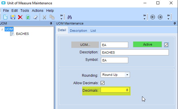

Check the decimals setup for your UOM ea under UOM maintenance. We change that on occasion to clean up fractional on hand quantities and it just so happens to max out at 8 which is what you are seeing on your form.
