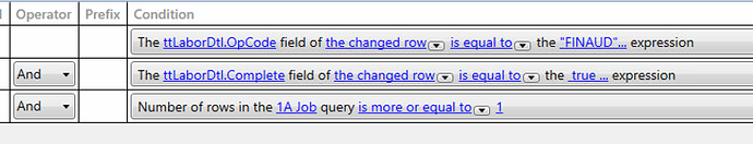

I have this condition then the code below on a standard data directive. This started in e9 and could use some cleanup, but it works.
