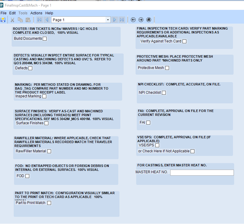

Here is what the inspection plan looks like in 2023.1 Inspection Plan Configurator Test Inputs. This is also what it looks like in Production 2021.2.5 Data Collection. Do you know how we can get it to look like this in 2023.1 Data Collection? I do not seem to be able to locate whatever setting is controlling this.

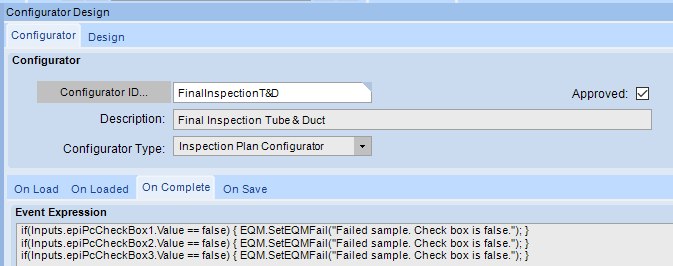

Additional Note: As we continue testing 2023.2 and trying to use the new “less than” kinetic inspection plans, discovered another issue. Since Kinetic does not launch the inspection plan configurator, the pass/fail rules that we set in the on complete section of the inspection plan configurator no longer work. The majority of our inspection plans are built using checkboxes.

We had originally created all inspection plans in the inspection plan configurator which creates a nice, user friendly inspection plan.

Now with the upgrade to 2023.2 the configurator does not get launched anymore.

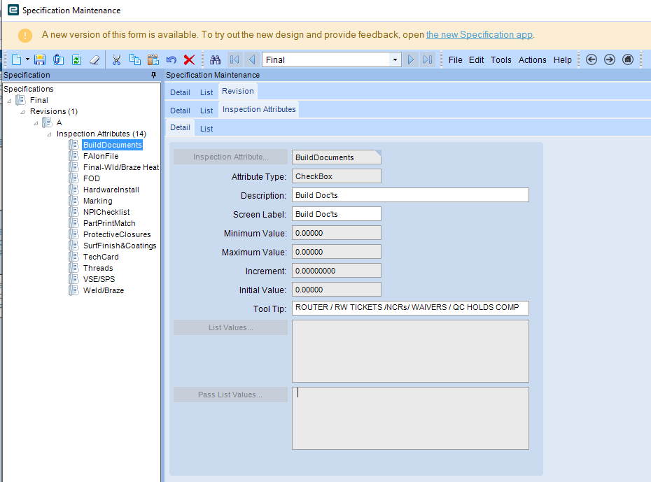

In the specification, I do not see a way to set pass/fail parameter for a checkbox? How do I do that? Almost all of our attributes are checkboxes.
With the configurator we could put that little bit of pass/fail code into the configurator for the checkbox attributes.
I am going off of memory since I don’t have 11 up yet.

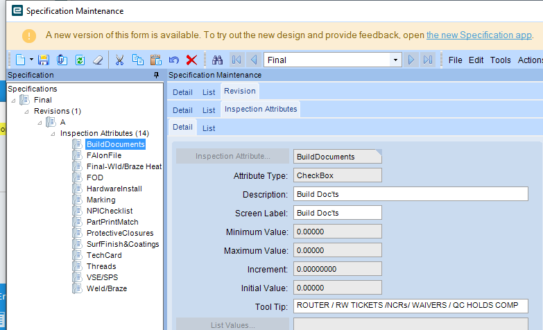

On the Specification, do you have the attribute marked so that TRUE is a pass value?
Would love to do that. But if the attribute is a checkbox you cannot enter anything - all greyed out. What am I missing?
Can you screen shot the whole window. I can’t see the pass/fail values.

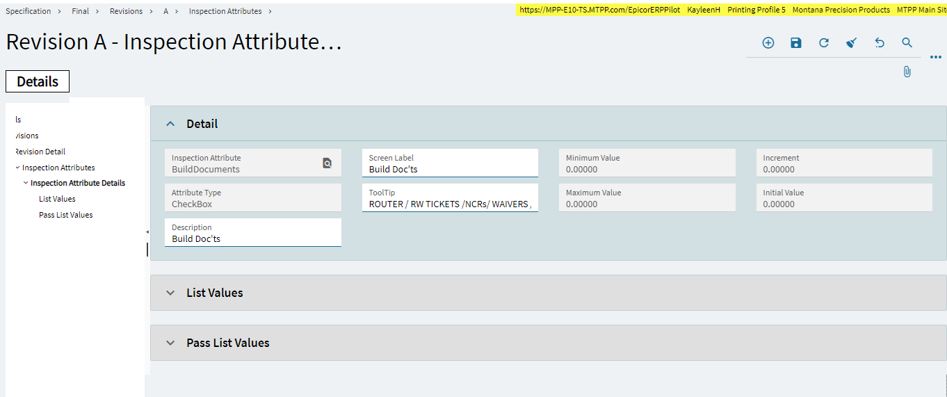

Kinetic View - cannot even open the sheet for pass/fail values
Wow! I was afraid that was going to be the case as I remembered the checkbox not needing to set pass/fail parameters but wanted to make sure. Have you tried removing the On Complete logic? I think the checkboxes should trigger a fail if they are not checked.
