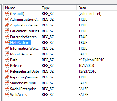

In the registry, navigate to: HKEY_LOCAL_MACHINE\SOFTWARE\Epicor Software\ERP10.1\1
Is HelpSystem set to TRUE or FALSE? If FALSE, Help wasn’t selected during the base 10.1.500.0 install, and can’t be deployed against an appserver.

and if HelpSystem is FALSE, I’m leaning towards the following as the simplest to address:
rename the HKEY_LOCAL_MACHINE\SOFTWARE\Epicor Software\ERP10.1\ key
reapply the base 10.1.500.0 install and select all the extensions that you’ll be using(I would just select all of the supplemental installs) : NOTE: please install into the same location.
reapply the latest 10.1.500.x patch so that the EAC gets updated
· rename the HKEY_LOCAL_MACHINE\SOFTWARE\Epicor Software\ERP10.1\ key
· reapply the base 10.1.500.0 install and select all the extensions that you’ll be using(I would just select all of the supplemental installs) : NOTE: please install into the same location.
[http://epiusers.help/uploads/default/original/2X/9/9222de79b22a786c0d243afcdfc0246ee31aed81.png]
· reapply the latest 10.1.500.x patch so that the EAC gets updated
