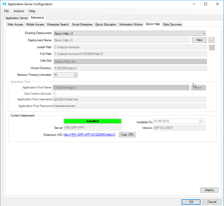

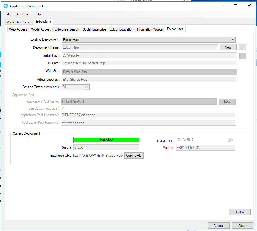

Can you go to your Admin Console and take a screenshot of your Help Extension Tab? Curious what settings and Poll you set in your deployment.
Btw here is one of mine:
Sure, here’s mine…
Interesting looks good - if you were to go to that URL you should get a HTTP Error 403.14 - Forbidden which means its working.
I wonder if something else is using your Port 80 - I would go to the IIS Settings and check your logs and bindings in IIS Settings.

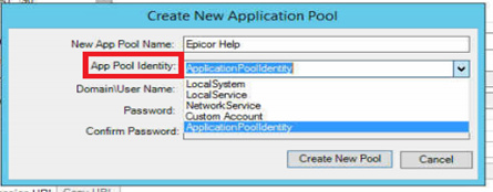

I usually setup just one Help site and then use it for all environments. I have found doing it this way is much simpler. One thing I would look at is your AppPool Identity access rights. I would also make sure your App Pool Identity is set to ‘ApplicationPoolIdentity’.
Try this:
Open IIS manager on the Appserver
1.IIS Manager > Sites > Website
2. Double click ‘Authentication’
3. Select Anonymous Authentication
4. From the Actions Panel, select Edit
5. Select Application Pool Identity and click ok.
