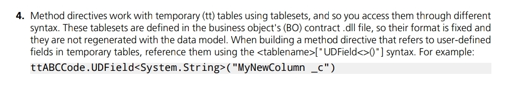

I use the form
ttOrderHedRow.UDField<System.String>("MyNewColumn")
When referencing UD fields in custom code.
You could try
ttCustomerRow.UDField<System.Int32>("Number01")
From the 'C# Programming Guide(onversion from ABL)
