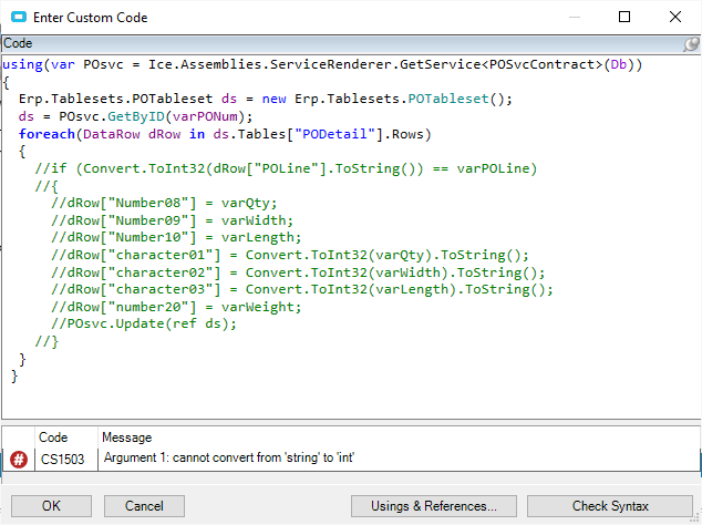

Anyone have an idea why I am receiving the error below?
It’s expecting a string and you’re giving it an integer.
After looking into it, not sure why you are getting that.
Erp.BO.PO.GetByID takes an integer, and you have an integer.
Did you change that variable after creating it?
Try commenting out the code, removing the variable, and save all the way out.
Then go back and put the variable back in and uncomment the code.
Sometimes implicit casting is dumb. Try putting (int) into the expression for PONum.
Maybe use a Long and not an Int?
It was not failing on the GetByID method. It was actually failing on this line:
foreach(DataRow dRow in ds.Tables[“PODetail”].Rows)
It is not able to resolve the table name so I changed it to:
foreach(DataRow dRow in ds.Tables[1].Rows)
I’m guessing table 1 is PODetail.
:rofl: Ahhhh!

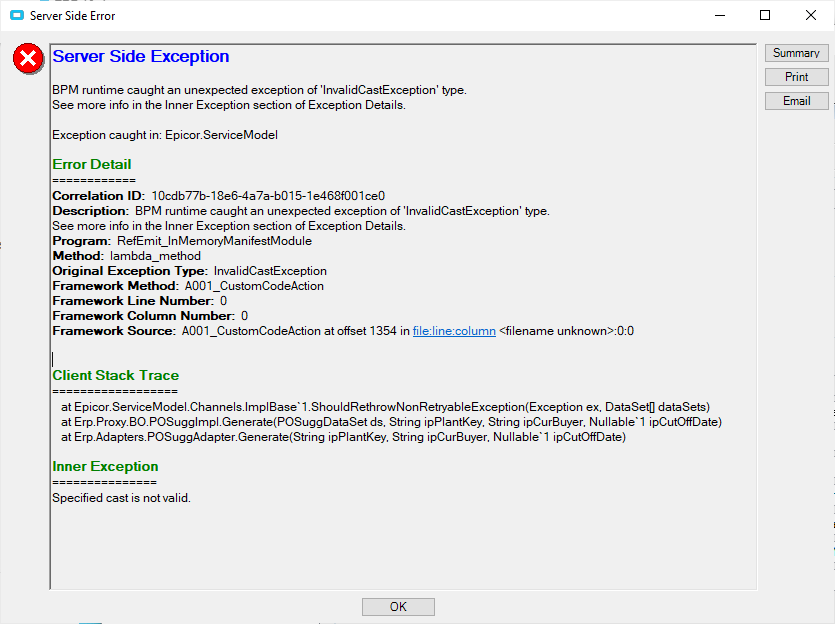

I found the PODetail.Number08 was defined as an integer. The BPM works now.
